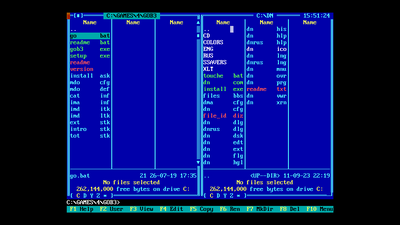

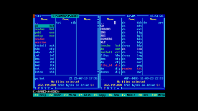

Reply 1537 of 1571, by Ant_222
The source looks good. Have you sample screenshots online demostrating the pixel-perfect upscaling of 5:6 PAR DOS games and programs (text-modes are a good test of pixel-perfect)?
Reply 1538 of 1571, by KainXVIII
tyrells wrote on 2023-09-12, 09:58:
I created such a shader a while ago: pixel_perfect.glsl. I'm not sure if it works with the latest SVN versions of DOSBox as I haven't tested it in a while.
Yeah, i meant your pixel perfect shader in previous post 😋
The attachment dn_002.png is no longer available
The attachment dn_001.png is no longer available
