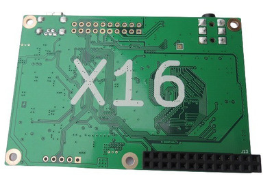

EDIT 25.06.2023 : X16 and X16GS are now released !
X16 is a High End Waveblaster + USB synthesizer board.
It also exists in X16GS - gamer's edition (with licensed Dream/Roland GS bank - for DOS gaming purposes).
Together with Hummtaro, the tools and soundbanks were finalized.
X16 will be preloaded with multiple soundbanks.
Launch prices are :
X16 : 135 euro : https://www.serdashop.com/DreamBlaster-X16
X16GS : 145 euro : https://www.serdashop.com/DreamBlaster-X16GS
In this thread i will document the features, post demos and provide additional support/information.
Documentation : https://serdaco.com/downloads/X16/X16_Documentation/
Demo : https://www.youtube.com/watch?v=9ql7mKiHZr0
Hardware Specs :
  • High End 16 core Dream 5000 series synth chip (SAM5716B), with up to 256 voice polyphony
  • Compact high quality green, gold plated PCB, 53mm x 77mm
  • Super low latency < 1ms
  • 8 MByte SDRAM for high quality effects
  • 1 GByte Flash for soundbanks
  • 2x13 Waveblaster header for integration on DOS sound cards and custom projects
  • Up to 400mA current consumption at 5V, when using all DSP cores.
  • USB-MIDI interface (Class compliant), USB mini connector
  • Stereo out, high quality 24 bit 112 dB DNR DAC
  • Expansion header for future expansion / OEM projects
Features :
  • High quality Dream synth engine, compatible with Dream 5000 SDK for custom soundbank design
  • High quality GS compatible reverb and chorus
  • 3 Stereo Insert Multi-Effects blocks (s (Distortion, Equalizer, Compressor, Chorus/Flanger/Phaser/Tremolo/Rotary, Delay), controllable by MIDI.
  • 4-bands Equalizer, controllable by MIDI.
  • Multi slot soundbank support, fast bank uploading over USB to flash using Serdaco multi slot upload tool - X16Manager.
  • Bootloader for updating firmware over USB
  • Support for DreamBlaster Presets

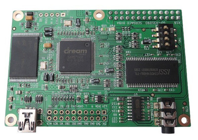

X16 (musician's card, without GS license) :
The attachment X16_FRONT.jpg is no longer available

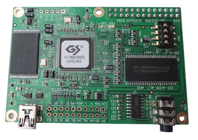

X16GS (gamer's card, with GS license) :
The attachment X16GS_FRONT.jpg is no longer available
X16/X16GS bottom side:
The attachment X16GS_BOTTOM.jpg is no longer available

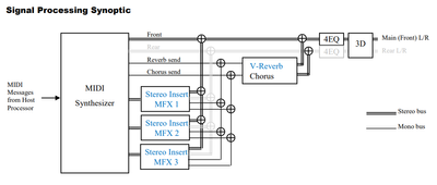

Synth Signal Processing Overview :
The attachment synth_architecture.png is no longer available

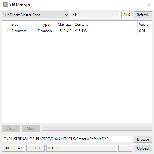

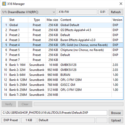

Reply 6 of 62, by dreamblaster
X16 Manager tool now working fine :
allows to :
- upload soundbanks and presets to different slots
- update firmware (in boot mode)
The attachment X16Manager.png is no longer available
The attachment X16ManagerBoot.png is no longer available

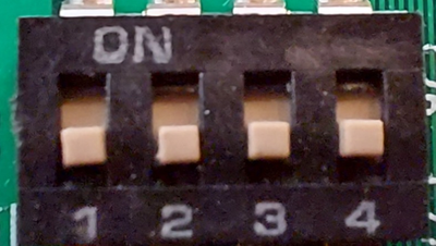

Soundbank selection can be done using midi commands, or the dipswitch on X16 :
The attachment X16Dip.png is no longer available
The 4 switches are represented from left (1) to right (4):
1 means the switch is turned on (moved towards pcb outside).
0 means the switch is off (moved towards pcb inside).
x means the switch does not matter.
0000: Bootloader mode (for updating only, does not play music)
x001: Synthesiser using soundbank from slot 1 at startup
x010: Synthesiser using soundbank from slot 2 at startup
x011: Synthesiser using soundbank from slot 3 at startup
x100: Synthesiser using soundbank from slot 4 at startup
x101: Synthesiser using soundbank from slot 5 at startup
x110: Synthesiser using soundbank from slot 6 at startup
x111: Synthesiser using soundbank from slot 7 at startup
1xxx: Reserved for future use
