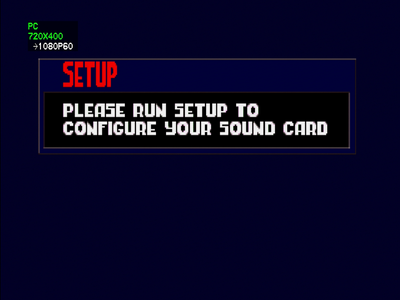

keropi wrote on 2022-07-18, 19:07:

I just finished setting up the card in my machine but Jazz refuses to start when I configure the game for GUS. It asks me to run sound setup:

I used the preinstalled ULTRASND directory from the website.
Reply 415 of 659, by keropi
IcySon55 wrote on 2023-04-25, 14:57:
some things to try as Jazz works fine under normal circumstances:
1. did you patch the game with PREPGAME? this is needed for the game to work with interwave
2. did you allocate in BIOS the irq/dmas needed for use with "legacy ISA" devices? (if you have a PnP bios)
3. use the updated IW.INI from the current ULTRASND.ZIP on the site (I see you use it, you got the v3 package right?)
4. there is some ram installed on the board, correct? if you run IWINIT /V it does it get detected?
there is nothing special needed otherwise, if irq/dma match, the game is patched and there is some ram on the board Jazz will just work

Edit 2: Got Jazz working with PREPGAME. I also had to patch it with TPPATCH because the CPU in the machine is fast enough to cause the game to crash on startup with a runtime error.
