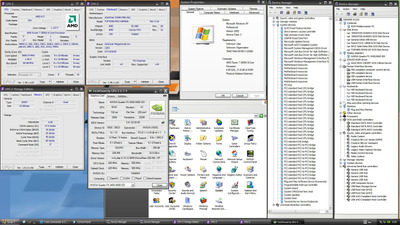

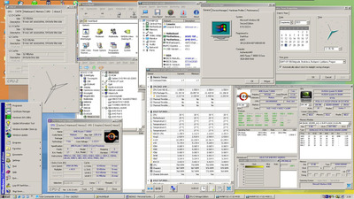

Reply 34 of 56, by DarthSun
XP runs even on the most modern computers. REMOVED, can be edited for brand new machines, Ramsey included the editor, AMD-Intel AHCI + other drivers can also be compiled. It has 128GB of RAM and all contemporary programs and games run nicely on my R3800X+B450. Moreover, even Win98 can be loaded with modded drivers, edited video driver+Loew mem/AHCI drivers, etc...
XP :
433.16 KiB
967 views
Win98 :
431.62 KiB
967 views
So it is not important to think about buying an older machine, retro systems run on the newest ones as well. In a Win98 session, DOS7.1 is also great, nowadays there are modern deceleration programs.

Reply 36 of 56, by DarthSun
Maybe you misunderstood, XP and W98 do not run virtually on my Zen machine, they are completely native, there are now suitable installers for this. Regardless of this, of course, you can also purchase an earlier machine with native XP support for the purpose.
The 3 body problems cannot be solved, neither for future quantum computers, even for the remainder of the universe. The Proton 2D is circling a planet and stepping back to the quantum size in 11 dimensions.

Reply 38 of 56, by DarthSun
The problem arises from the fact that the XP installer switches to its own USB driver during setup. Under DOS, for example, the mouse and keyboard work with the legacy USB setting of the BIOS. However, with the Zone Integral editor, the appropriate USB support can be included in the installer.
In the case of Win98, it is more complicated, you probably need at least a PS2 port for the mouse. The USB keyboard works, but the mouse is buggy, the USB drivers ported from the X58 package work partially, if I remove or disable it, the keyboard and flash drives stop as well. I'm still looking for a solution to this. But after all, XP is in the center here, I ported Win98 just for the sake of interest.
