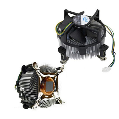

Don't forget that you'd probably have to change the heatsink as well, which bumps up the cost. It'd have to fit inside the case of the HP too.

At stock clocks you might get away with the stock HP cooler, it wont be amazing and will run a little hotter but it should be fine, I wouldn't do this with a E8600 though but a Q9300 or E8200 would be ok.

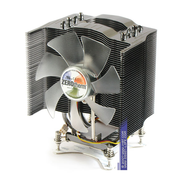

I run a Q9550 on one board (95W TDP) but I use a Zerotherm cooler because the intel ones suck.
Reply 15 of 33, by Solo761
That probably wouldn't fit since it's SFF case 😅.

If theat is a concern, OP could go with something like a Q9550S, those are just 65W officially so the stock cooler for the also 65W E6550 should be fine.
IF the board supports the CPU.
