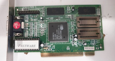

I am going to try the CL-5446 for older DOS games.
Questions;
1) Do I need to install any specific drivers under MS-DOS 6.22
2) Has anyone tried to upgrade this card to 4MB instead of 2MB as stated here http://old.vgamuseum.info/palcals-collection/ … d5446-hc-a.html ? Also what type of RAM is suitable to fill in the empty sockets, are they really rare / hard to find ?
3) I have never seen any video gameplay with this card, seems a bit underrated and not even here on Vogons could not find many related posts, even though it is highly recommended due to high compatibility with DOS games. The only video I could find is by Phil here https://youtu.be/N_5suEoXTc8
Reply 1 of 11, by swaaye
They just aren't all that exciting, which is why you don't read much about them, but yeah they are certainly capable of playing DOS games. These are the sort of cards you'd get in your basic mid '90s SOHO Pentium PC. It'll be slower in DOS than Voodoo3 and GeForce 4, but that might be a good thing in some cases.
You don't really use drivers for DOS games. Some games look for VESA VBE support for higher resolutions and color depth, and the card will have some version of that built into its BIOS. There is a free utility called UniVBE that will upgrade it to VBE 2.0/3.0 and games sometimes include that. It's usually only something to worry about if you run into problems with a game.
RAM upgrades are about higher resolutions + color depths in Windows. I don't think it's worthwhile unless you just want a project. The other cards are much faster Windows accelerators and probably have much better VGA signal quality too.

I did some quick and dirty benches in my P1 system a little while back. I hadn't heard of the 5446 at the time, so I was surprised to see it beat the S3's and come second only to an ARK2000.
https://forums.overclockers.com.au/posts/18990366/
I haven't ever given it an extended run to gauge compatibility. Cool card to have in the kit for similar builds though.
Reply 5 of 11, by Gmlb256
Pierre32 wrote on 2023-05-17, 01:27:
Banked VESA video modes on S3 cards are usually slow without resorting to S3SPDUP (requires S3VBE20), so it isn't surprising to see lower scores in both SVGA benchmarks. The only S3 card that score well in those tests was the Compaq ViRGE/GX because it has VBE 2.0 onboard.
