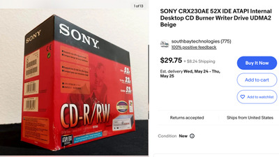

Don’t buy those old used CDROM drives. Try to find a NEW Sony 52x. Or even a used one. These are very reliable. The faster the CDROM drive the better but don’t get a DVD. Stick with the CDR or CDRW.

Based on peoples' personal experiences there might be multiple "right" answers. I'm all for period correct but I'm curious why you're saying go for the new stuff Intel. Is it because the old ones are 2nd hand and may break or is there some technology related reason?

Laser diodes, and other components that aren't easily replaced, go bad. Generally, going for the late IDE era drives is easiest way. They're cheaper and more easy to find, and can read and write DVDs too. You just have to be careful that the drive can output Redbook audio, if you care about that. An ASUS drive I got had audio out headers but were functionally useless.
Right now I have 3 NEC ND-3550A. One of them I think has a bad diode or needs a firmware update, because it has issues reading CD-Rs, but the other two are good. I don't know about over burning but they can do everything you need CD and DVD wise minus being period correct. Plus they're cheap as water on eBay.

If your main purpose is being able to read CDR disks, newer drives will prove more reliable in that respect.
While I prefer older, slower drives (i.e. 2x to 8x), I find they are spotty at best when it comes to using CDR disks.
For example, I have a Toshiba 6x that reads CDR disks no problem. On the other hand, I have a couple older Mitsumi drivers (4x and 8x) that have trouble with them.
The one downside of faster drives is they tend to be a lot noisier and take longer to spin up to speed. But they can also typically be throttled using speed limiting programs.
