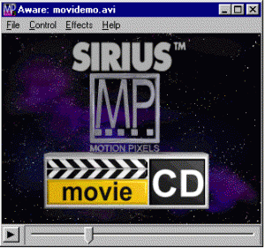

    87.01 KiB
    817 views
    MovieCD Player
    67.76 KiB
    817 views
    Aware Player (manual file opening) and MovieCD Features/Requirements
