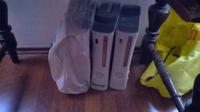

Reply 49440 of 58168, by pentiumspeed
ediflorianUS wrote on 2023-06-05, 12:16:
PcBytes wrote on 2023-06-05, 12:09:
A quick repaste with MX6 should get you going. At least that's what I have to do on my RGH'd Jasper 360, after I swap it in the elite case, and I might be getting a 750 or 1TB drive for it.
I'm afraid to brake the back end of the case , they are fragile , and it's in good state. Will probably blow out with compressor and that's it for now. (I don't have the special opening tool for the back end locking-clips, and anything else leves a mark) at least its 2008-7-11 dated... or someting like that.
LE. Rest of the lot..
As tech repair at work, I see lot of consoles in 5 years, I will tell you:
No, no, you, need, absolutely must take these 360 consoles apart for several things, which you will need to buy the inexpensive special multi-pronged tool and the x-clamp removal tool.
Remove dust build up, which will be massive in these due to EMI shielding boxes has lot of crevices between EMI and plastics for big clumps of dust hiding there.
Repaste heatsinks after completely clean both chips and heatsinks.
Also to check for illegal X-clamp modifications. People were doing absolutely wrong doing this. When this mod was done which removes X-clamps along with original screw down pegs, and used four regular screws, instead the circuit board to clamp the chips to the heatsinks instead of X-clamps. Over time the PCB will relax due to creep due to resin glue is plastic and pressure on the chips is totally lost. Microsoft knew what they were doing with X-clamps design long ago, was very sound design and was used up to Xbox one X. The same design still used on Xbox Series X except for one difference; X-clamp is held in place with four screws. Xbox series S still used X-clamp.
The real reason for dying were their original TIM microsoft specifically used was thermal phase that only melts where heat is on first power cycle during assembly at microsoft's, over time, with thermal cycling that developed air bubbles and thermal particles pumped out out of the space. The TIM reharden as spacer *on the* APU and GPU packages holding heatsinks apart. This is going on still with all of their microsoft consoles including Xbox series S and X. The real fix was replace the TIM with high end thermal paste.
PS3 and PS4 (all) used regular paste instead, less issues but good idea to rebuild them by taking apart for a cleaning and use high end thermal paste.
Cheers,
Great Northern aka Canada.
Reply 49441 of 58168, by PcBytes
Hoo boy, Microsoft's TIM compound is a special kind of curse. I've seen that thing become literal adhesive, kinda like double sided tape.
As for the ones I've seen through romania - none I've seen to this day have had the stupid Gamestop bolt mod done. So far I've had quite a bunch of Falcon v1 boards, a v2, a Xenon non-HDMI and this Jasper. All still had their classic black Torx screws on the HSF mounts.
PS3's IHS delidding is another scary animal I wouldn't tackle even if paid its weight in gold. PS4 didn't dwelve into it more than once on someone else's unit, but it looks like the APU inside it should be okay with a repaste, glad to see Sony rethought the cooling process so you don't have to delid.
Too many horror stories and very little space to work with make recipe for absolute disaster. The 360 at least uses somewhat exposed chips, which I see as a better approach when repasting - the PS3's CELL has very little error margin when delidding - something I wouldn't ever be okay with doing, especially on a CECHC04/G04 unit.
@ediflorianUS - you can use a paperclip or small flat headed screwdriver (IIRC I used a Parkside kit w/ 1.5 sized bit) to pry on the backside clips. That's what I used on mine, at least.
Reply 49442 of 58168, by ediflorianUS
PcBytes wrote on 2023-06-06, 05:10:
Hoo boy, Microsoft's TIM compound is a special kind of curse. I've seen that thing become literal adhesive, kinda like double si […]
one of mine had the X clamp mode , I just rechecked evrything and let it bee. Other had big car bolts so I let that as well, when I ever need hard play I will repaste maybe(this black one - the rest as they where already opend-moded had paste changed). Most of them had bad capacitors , and with correct new-ones recaped they started up fine with no RROD.
correct tool , I tryed building one from case metal part's (pc-tower) but was unsuccessfull.

Reply 49451 of 58168, by pentiumspeed
ediflorianUS wrote on 2023-06-06, 08:08:
You have to undo the mods, it is a priority. Is not working anymore as clamp due to PCB (board) already relaxed with time where real x-clamps still do their job. Get more dead 360 consoles and rob the parts to repair yours.
As evidence, I bought one of 360 to add to my collection early on 2 years ago, found one modded this way and when I undid the screws for heatsink on that modded 360, the tension in the PCB did not bounce back, so I junked it since this one was pre-jasper era, as I can get lots of 360 consoles easily and eventually found Jasper and later, also a slim. All of them is full of dust too.
Cheers,

I was under the belief that Microsoft like Sony had switched to Liquid Metal instead of TIM.
Reply 49453 of 58168, by BitWrangler
Yah, that's what has been said, it WAS liquid metal type stuff, phase change, but it's pumping itself out over time and leaving it dry.
Reply 49454 of 58168, by Trashbytes
BitWrangler wrote on 2023-06-06, 23:04:
Gallium based LM like the Thermal Grizzly stuff does this with desktop CPUs but it can take a good number of years, its odd that the PS5 and Xbox Series X would be suffering from it so soon. Not sure what the older consoles would have used but perhaps an earlier version of LM which isnt Gallium based.
Either way changing the TIM isnt too difficult .. getting into the consoles is the hard part... so many stupid security screws and shitty plastic tabs.

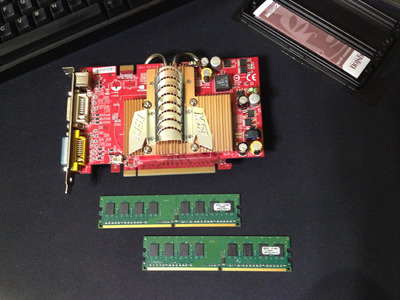

Reply 49457 of 58168, by Maryoo
As usual, I couldn't resist the low price and bought the MSI Geforce 7600GT for $4.5 with shipping and 2x1GB DDR2 1066MHz for the same price. I am very pleased because the result in 3DMark2000 increased by exactly 30,000 points compared to the Radeon X600 that I used so far. I'm trying to get the most out of Windows 98, currently on sockett 775 with Core 2 Duo E8500 oc to 3.55GHz.
