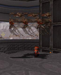

gerwin wrote on 2022-12-13, 02:01:
I also noticed another thing. The boss of Duke Nukem 3D looks corrupted, as in image below (map E2L6), same goes for the Flying heads in Ion Fury.
Verified this in official eduke32_win32_20210927-9607 and current eduke32_win32_20221026-10165 on Windows 7 x64. The 2018 version that I mentioned does not have this problem.
Finally managed to get rid of this rendering problem with the mentioned characters, in both eDuke32 and Ion Fury. A single setting:
r_hightile=0
Defaults to 1 if not set.
https://wiki.eduke32.com/wiki/Console_commands
https://forums.duke4.net/topic/11965-the-inde … ghtiles-thread/
For me this was still an issue with the latest official eDuke32 build running on Windows 7 x64 (Radeon HD 7750).
Also I changed my Windows XP Radeon driver from v13.1 to the very last iCafe v2015 Catalyst driver, and now OpenGL framerate jumped up significantly. A scene that was 24 FPS before now shows 86 FPS. (I skipped the v14.4 driver version there, but I have reason to believe it has the exact same OpenGL component as v13.1.) I am not sure about the underlying cause for the framerate difference, maybe a shader compilation hickup, like I saw recently in the Force Engine project?

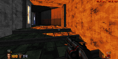

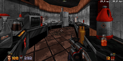

So first big bottleneck solved. A while ago, we had private discussion with Srandista how older version of eduke32 (pre-2019) were much faster. Somewhere around 2018-2019 there was implemented something in tree which introduced weird lag or wrong responsiveness feeling in game (at least for me). And I finally know what it is.
It was timer! All eduke32 version up to v.7972 (incl.) are still using timer (I firmly believe) written by Ken:
sdlayer.cpp:
// All things Timer
// Ken did this
static uint32_t timerfreq;
static uint32_t timerlastsample;
int32_t timerticspersec=0;
static double msperu64tick = 0;
static void(*usertimercallback)(void) = NULL;
// inittimer() -- initialize timer
int32_t timerInit(int32_t tickspersecond)
if (timerfreq) return 0; // already installed
// initprintf("Initializing timer\n");
#if defined(_WIN32) && SDL_MAJOR_VERSION == 1
int32_t t = win_inittimer();
if (t < 0)
return t;
#endif
timerfreq = 1000;
timerticspersec = tickspersecond;
timerlastsample = SDL_GetTicks() * timerticspersec / timerfreq;
In version 20190813-7976 there is introduction of SDLTimer and timer.cpp file:
------------------------------------------------------------------------ r7976 | terminx | 2019-08-13 07:44:16 -0700 (Tue, 13 Au […]
r7976 | terminx | 2019-08-13 07:44:16 -0700 (Tue, 13 Aug 2019) | 1 line
Replace separate timer implementations in SDL and Winlayer with a shared implementation based on std::chrono
r7975 | terminx | 2019-08-13 07:44:09 -0700 (Tue, 13 Aug 2019) | 1 line
There's no way this is correct.
r7974 | terminx | 2019-08-13 07:44:05 -0700 (Tue, 13 Aug 2019) | 1 line
Name fix, I guess?
r7973 | terminx | 2019-08-13 07:44:00 -0700 (Tue, 13 Aug 2019) | 1 line
Fix remaining casts to vec2_t/vec3_t
See http://svn.eduke32.com/listing.php?repname=eduke32 for more details.
I should explain: I'm still rocking old EEE PC for this occasion. Intel Atom inside. 1-core 32-bit weak CPU. 1.6Ghz but can be stepped-down to 800Mhz. Unfortunately, poisoned by HT-technology (because it was cool back in the day). It creates two virtual cores for operating system, but somehow is still running on one physical core in CPU. eduke32 was one-thread application (I believe) but it started using threads for services like music and miscellaneous stuff. And this exactly is problem for me as SDLTimer is created as separate thread assigned to different virtual core than main game loop.
As is CPU context switched between two virtual cores, updates for timer aren't tied to main rending loop and thus entire game world is updated as CPU time is unperiodically assigned to core running SDL timer. Resulting in weird update lag. But believe it or not, old timer is still there:
#ifdef HAVE_TIMER_SDL
default:
case TIMER_AUTO:
case TIMER_SDL:
return TIMER_SDL;
#endif // HAVE_TIMER_SDL
#ifdef _WIN32
#if !defined HAVE_TIMER_SDL
default:
case TIMER_AUTO:
#endif // !HAVE_TIMER_SDL
case TIMER_QPC:
return TIMER_QPC;
#endif // _WIN32
#ifdef HAVE_TIMER_RDTSC
#if !defined _WIN32 && !defined HAVE_TIMER_SDL
default:
case TIMER_AUTO:
#endif // !_WIN32 && !HAVE_TIMER_SDL
case TIMER_RDTSC:
return TIMER_RDTSC;
#endif
it's simply defined by HAVE_TIMER_SDL as default value. I redefined HAVE_TIMER_RDTSC as default value, complied entire engine and problem solved. Combined this with disabling HT-technology (nosmp parametr for linux kernel) resulting in smooth frame rate in eduke32 and unbroken music playback again. Even for newer git versions.
This might help someone struggling with similar problem.

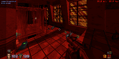

Reply 128 of 132, by Grunt
I don't know. nosmp or maxcpus=1 as kernel parameter and RDTSC timer did the thing for me.
Edit: And OG resolution: 400x200px 😉
