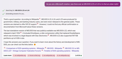

Was fooling around with the new Bing and asked it this question, but was there any real evidence? When I worked in the military, as soon as NT 3.51 was certified we started using that, MS-DOS 6.22 was only really used to prepare a disk or used on legacy training systems, nothing important, so I think it is an urban myth, but would be happy to be wrong.
Did a search on this years ago, but never found anything concrete, what are the thoughts or proof from the wider community?

The funniest thing about it is that the stupid program links to the vogons forum as the (only?) reference to the question, and now since you posted about it, it will have lots more speculation to index, and now the circle is now complete. It got what it wants; more data.

And then there is Google's Bard, it starts well and... Humanity is safe. These things do not even make a good joke yet.
The attachment Capture.PNG is no longer available
