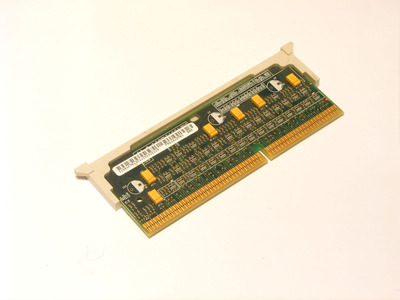

Anyone knows if with GA-6BXD motherboard If I were to install win9x and the OS cant use 2 cpus anyway can I just remove one of the cpus or would I need some kind of terminator card in the empty slot that I would not have?
Reply 1 of 9, by Sphere478
Ideally you would have a terminator for the unused slot/socket.
But you can try it, and if it works, then roll with it. 🤷‍♂️ If stability issues, revisit the problem.
GTL busses are supposed to have stray ends terminated to prevent reflections.
You could maybe instead just leave the cpu in there…? It doesn’t really matter that it is there does it?

Reply 2 of 9, by PC Hoarder Patrol
Baoran wrote on 2023-08-10, 02:37:
Generally the answer is with a terminator card is fine; without may be OK depending on which cpu...
Board makers only tended to ship terminator cards with motherboards once coppermine cpus were introduced as these were more prone to signal reflections
Like @Sphere478 say, try it without first, though there is a broader recommendation that in single cpu mode use slot #2 (the one nearest the memory slots), but if instability arises then add a terminator card in slot #1

Reply 7 of 9, by shamino
Home build oriented motherboards like this generally try to work without requiring a terminator.
I don't think I needed a terminator on the Asus P2B-D, and I know I didn't need one on an Epox. It worked totally fine without one.
The Intel, HP, and IBM boards I've used though each required a terminator or they wouldn't POST.
I think I've read about a difference in the design of the boards that makes terminators mandatory, but I don't know the specifics. Expensive prebuilt servers/workstations are likely to prefer that design because they like to be strict and formal about everything.
Home DIY oriented boards come from a different culture that tries to be more flexible.
