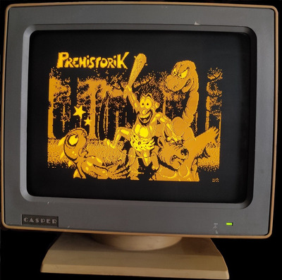

The argument about CRT vs OLED comes up in these topics all the time, it's so damn funny.
Some people always feel the need to compare these technologies like it's a holy mission. CRT is better! OLED is better! µLED is going to be better than everything ever made!
Screw that noise guys, nothing beats the black levels on this CRT:
257.82 KiB
1922 views
Tens of millions of prescription glasses don't lie.

Reply 113 of 120, by Capcholo
appiah4 wrote on 2023-08-16, 11:19:
Casper eh.. That is a rather poor quality Turkish OEM..
That monitor was probably junk even for its time.
Maybe, but this model was made in Taiwan for an American OEM company, Electro Service Corp, in 1989. Still nice and bright tube, no burn-in.
