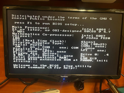

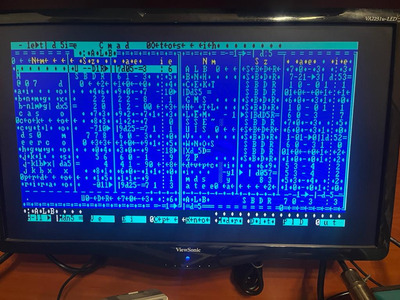

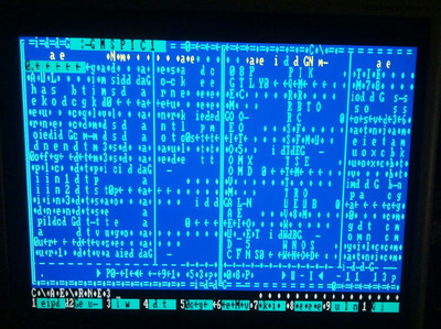

Good evening ! Forced to ask for help, I am no longer able to solve the problem on my own.
So, CGA Redux card is assembled and even launched by me. However, in the 486DX motherboard it does not start at all; in a set with 386SBMC by Alexandru Groza starts, but quickly "hangs"; in a set with Xi8088 or Micro8088 by Sergey Kiselev almost works. The key word is "almost" (((
1) In the 40*25 mode, individual symbols fall out, the screen is generally readable, but the falling symbols are alarming... I did not find any regularity in the symbols that are not reproduced.
2) In graphics modes, the picture is almost completely adequate, only some pixels are "broken". I did not find any regularities in the "broken" pixels.
3) In the 80*25 mode - every second symbol is dropped, replaced by an "artifact", the screen is almost unreadable ... The regularity is obvious, besides, the attribute bytes are written and reproduced correctly - ????
Memory chips tested in a working ZX Spectrum clone. Almost all small logic tested in T48.MC6845 - i've have 3 pcs, three are known to be alive, the result is the same.
I hope that more experienced members of the community will have some thoughts on how to solve this problem. I apologize again for my imperfect English.

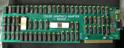

CGA and also CGA Redux circuit is sensitive to the series of IC used. The readme from github says:
U4,U5 and U101 should all be 'S174s
U9,U10 are 74153 chips.
U28 actually an 74S10
It also says that the author tried to use the 74LS series instead of them and everything worked for him, but this does not mean that it should work for you. In addition, if you use and order chips from China with Aliexpress, then now there are many fakes of the 74LS series from the 74HC series (remark).
So, chips marked as 74S on circuit must be 74S series, not 74LS or 74HC or whatever.

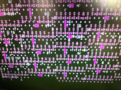

I have seen similar behavior on my board:

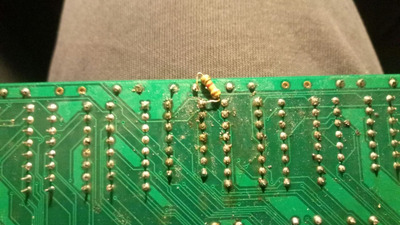

To fix it, I pulled down the /LCLK signal to ground with a 1K resistor:
146.98 KiB
705 views
You can try this, but my board is built on Soviet chips and therefore this fix may not work for your case.

Reply 2 of 7, by Vlodek_d
Good day ! My board is also almost entirely built on Soviet microcircuits (90% -1533, 5% - 555, 5% - 74LS, RAM - РУ5Д). So I will definitely try your method. As soon as I have free time. Thank you in advance !

Reply 3 of 7, by Vlodek_d
Good evening !
I also suspect that the problems with my CGA Redux card lie somewhere in the /RAS, /CAS, or /WE signal generation. The fact that you had an almost similar situation only strengthened my suspicions. Because I was still not sure about the control signals of the address registers /EN_CPU_CAS_ADDR, /EN_CPU_RAS_ADDR, /EN_CRT_CAS_ADDR, /EN_CRT_RAS_ADDR. But, probably, it's not about them.
So, I couldn't stand it and today I tried to pull-down the /LCLK signal, as you advised. And ….. it got even worse…. (see photo).

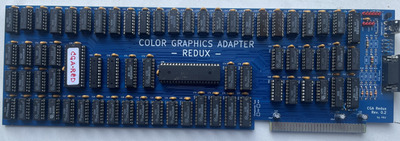

About the demandingness of CGA Redux to the types of chips used. I couldn't even think that in some schematics there could be a situation that the microcircuits used would turn out to be too fast! Because, usually, the opposite happens - you have to look for the fastest possible ones. And that is why I keep a stock of microcircuits K1533 (74ALS) and K1531 (74F). I try to keep even K555 (74LS) to a minimum. Let alone K155 (74) and K531 (74S).
@Tronix : I looked carefully at the photo of your CGA Redux. You used almost the entire set of ex-USSR TTL logic - K555 (74LS), K1533 (74ALS), K531 (74S). And even somewhere they found such a rarity as K1554TB9 (74AC112). Although, it seems, is it CMOS? And although most of the microcircuits you use are K555 (74LS), you still put K531 (74S) in the most "responsible" places. Even on panels - surely you have experimented with them?
I have almost no K155 (74) or K531(74S) series chips. So I started "randomly" changing the control logic to K1531 (74F) chips. Just for an experiment. With each replaced chip, the image became more "dirty" until CGA Redux stopped rendering images at all. So, it may really be a matter of the type of microcircuits used, especially those responsible for generating dynamic memory control signals.
So I quickly ordered a large handful of different K531 (74S) series chips online. Moreover, they can still be found at a ridiculous price (about 10 cents per piece). Will receive an order - will continue my efforts to complete CGA Redux. But I still hope that CGA Redux can work on 74ALS microcircuits. So I would appreciate any advice.

Reply 7 of 7, by Vlodek_d
Thanks to Tronix for the tip. The solution to the problem turned out to be exactly as he described. Replacing several microcircuits with 74S (K531) helped, the board works flawlessly. All the same, I don't understand why it didn't work when I replaced the same microcircuits with 74F (K1531)...
