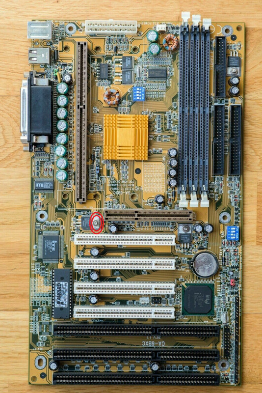

Gigabyte GA-6BA is a very nice motherboard, sadly gigabyte back then had issues with some video cards like the voodoo or TNT. A lot of models from gigabyte with this problem, that is why some just avoid it.
I happen to have one gigabyte GA-6BA revision 2.9 motherboard and the board is bad for using with a voodoo3 cards because it can´t provide enough 3.3v to AGP.
Gigabyte created a revision 3.0 where they added 2 jumpers near the middle of the 4th ram slot, and they even printed in the manual that those jumpers are for voodo3 cards.
This is the revision 2.9 motherboard, sadly those 2 jumpers were added by gigabyte on revision3.
and here there is some explanation of what gigabyte did to fix on revision3.0
Gigabyte GA-6BA and Voodoo 3 jumpers
So i always thought about, what happened to all the people that bought it back then, i mean voodoo3 was very popular, tnt was popular too, was there a fix for this? what could be done?
and i found this! http://www.plasma-online.de/index.html?conten … gabyte_tnt.html
a fix for the issue, that consists of soldering a wire from the power supply connector 3.3v to a component that is next to the AGP slot, but the fix only explained with pictures how to fix it on 3 gigabyte motherboard models.
GA-6BA rev2.9 does not have that component next to the AGP slot, so i wanted to know if it is possible to do this mod on GA-6BA , and where should the wire be soldered to.
Perhaps more experienced people in the forum can provide a better understanding on how to pump up the 3.3v for the AGP slot and to what component can it be soldered to.
Reply 1 of 11, by shevalier
SETBLASTER wrote on 2023-09-03, 04:13:
Gigabyte engineers had a clouding of their minds.
Two voltage sources are not connected in parallel, only current sources are connected in parallel. 🙁
For normal operation, it is necessary to remove the linear regulator (remove it completely) and direct apply a voltage of 3.3V from the ATX connector.

Reply 3 of 11, by SETBLASTER
shevalier wrote on 2023-09-03, 04:55:
Gigabyte engineers had a clouding of their minds. Two voltage sources are not connected in parallel, only current sources are co […]
so true!
the board is beautiful, i can´t understand how gigabyte engineers messed something like this in so many models.
Glad you could explain me this with a picture. I just have a couple questions:
1) how did you figure out the correct regulator is that one in the picture for AGP?, (and not the one on the left of the Orange heatsink ).
2) (thanks for telling to remove the regulator completely and soldering a cable to the middle pin), Did you have the same board with the same problem in the past?
Reply 4 of 11, by shevalier
SETBLASTER wrote on 2023-09-03, 05:47:
BX is quite simple board. Vcpu+Vtt+V2.5V near the slot/socket.
AGP+RAM+Chipset (+PCI - optional) that`s powered from 3.3V
Wire instead of LX8383 is standard procedure for boards SS7 till MVP3/Aladdin

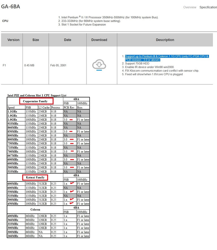

thanks shevalier! Oh by the way, is it really neccesary to connect the wire to all 3 pins in the PSU connector? or only to 1 pin is enough in the PSU connector?
i just learned yesterday that this GA-6BA revision2.9 has ANOTHER problem from gigabyte hahaha.
Aparently they mention that the maximum CPU you can put in it is 550mhz but then they released a new bios mentioning that it can go up to 1.1G only if you have revision 3.0 of the motherboard and an Adapter PGA370 (Socket 370) to Slot 1.
( i wonder if they are talking about an PGA370 adapter that already has regulator in it, or a PGA370 adapter without a regulator in the pcb (cheap ones). But i would not be able to try because my board version is 2.9. Or do you know there could be a fix for that too on my 2.9 board so i can use a 1GHz cpu with a an adapter?

Reply 8 of 11, by shevalier
SETBLASTER wrote on 2023-09-03, 14:55:
if it were possible, ATX would be called ATX18 pin and sold for the same money.
Gigabyte is not sure that this revision of the board will work on the 133 bus.
Maybe this is due to the fact that the clock IC does not support this frequency, or the layout of the board may not be very successful.
Usually a 440BX with 2 RAM sticks starts up on bus 133.
Bad luck, sorry
https://pdf1.alldatasheet.com/datasheet-pdf/v … 280PVC-11S.html
100MHz only

Reply 9 of 11, by PC Hoarder Patrol
thanks shevalier! Oh by the way, is it really neccesary to connect the wire to all 3 pins in the PSU connector? or only to 1 p […]
shevalier wrote on 2023-09-03, 08:50:
BX is quite simple board. Vcpu+Vtt+V2.5V near the slot/socket. AGP+RAM+Chipset (+PCI - optional) that`s powered from 3.3V Wire […]
picture:
Your board should easily support a 100MHz FSB skt 370 coppermine on a decent slot1 adapter, to at least 800MHz (possibly 850MHz too) - beyond that (1.0 / 1.1GHz) it may work but with increased chance of instability.
I'm currently running an 800MHz cpu + ABIT SlotKET !!! adapter on my revision 2.5A board (F1 BIOS) and 1 gig of memory, and its completely stable
Reply 10 of 11, by SETBLASTER
PC Hoarder Patrol wrote on 2023-09-04, 01:52:
thank you for letting me know of this. Its nice to know that someone else has the same board running better than what gigabyte says its the maximum for a certain revision.
Because according to them if you have revision lower than 3.0 you are stuck with katmai, and gigabyte says coppermine are only for slockets + revision3.
That abit sloket is one of the good ones. The market was plagued with no brand ones. I happen to have some with no brand, and i got i think a good one fron gigabyte: ga-6r7pro . Maybe that one works with a 800MHz pentium3.
PC Hoarder Patrol, did you mod it to make voodoo3 work properly like what was posted some messages before in this topic?
I always wanted to know what is better, this GA-6BA board or a soyo SY-6BB, because according to soyo you can only reach katmai 600mhz on the soyo. But some people say they could install higher cpus.
