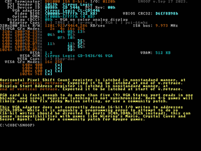

Reply 10 of 18, by clb
Awesome digging, that's definitely it. No wonder trying to repro DOSBox video register state completely missed this scenario.
Updated SNOOP to detect this:
147.52 KiB
2203 views
https://github.com/juj/crt_terminator/blob/d3 … CPP#L1023-L1069
