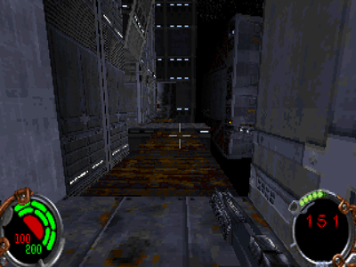

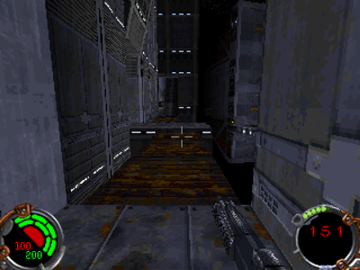

I just checked Star Wars Dark Forces 2 and its 640x400 resolution is meant to be viewed at 16:10; it's vert-.
However the 320x200 mode is quite odd. The viewable image is vert+ compared to 320x240 and 640x480. Setting the output ratio to neither 4:3 nor 16:10 matches the image at 320x240/640x480.
