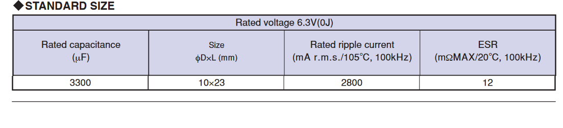

checked them all, it appears they are not good. Another person from the forum provided me the originals caps info:
rubycon MBZ 3300uf 6.3v (3300uf 10x23mm ... rated ripple current mA r.m.s/105C, 100kHz 2800 ... ESR mohms max/20C,100kHz 12 )
if i havet to follow:
1. = or higher ripple current then the originals
2. = or lower ESR/impendance then the originals.
from those "substitutes", :
this one https://www.digikey.com/en/products/detail/ni … J332MHD/2598204
has higher impedance (16) and lower ripple (2500)
this one https://www.digikey.com/en/products/detail/ni … J332MHD/2598041
has higher impedance (21) and lower ripple (2360)

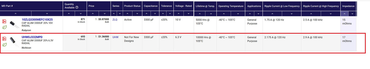

-The close one is this one from the screenshot below, but the ESR is 17 instead of 12
- When i go to 16v things start to match, but sadly , the diameter of the caps is 12.5 and not 10mm so they would not fit correctly on the motherboard.
- I also have some doubts on what should i check for ripple, should i be looking at the ripple current high frequency or low frequency? I am only making sure that the 100kHz ripple current HIGH frequency is bigger than the original cap.

Reply 8 of 52, by smtkr
I'm not an electronics engineer, so take this advice for what it is.
1. Just match the capacitance and make sure you get >= voltage of the original. Then just try to get as low ESR are possible without laboring over it.
2. Stop quibbling over the other specs. These circuits are built with tolerance and, frankly, these characteristics vary with temperature and frequency anyway. They also change over their lifetime. The engineers that designed the power circuits likely built in a decent amount of tolerance.
3. If you absolutely have to hit some ESR target, I guess you can dig into the polymers
People being worried about capacitors is basically an Internet meme at this point.
