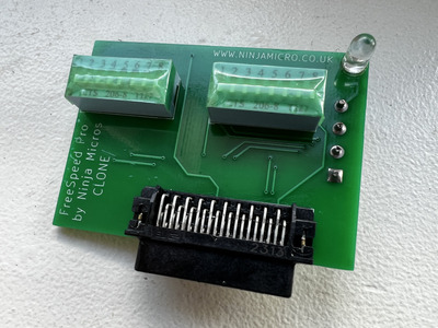

Reply 45 of 78, by paradigital
Absolutely no idea why I can get an FX series card to work, yet no go for me with 6 or 7 series cards.
I’ve just built up my goldfinger device (the FreeSpeed Pro as cloned by Vogon’s member wiretap), so I might be able to push further yet.
Not dug out the hot-air soldering station for a while!

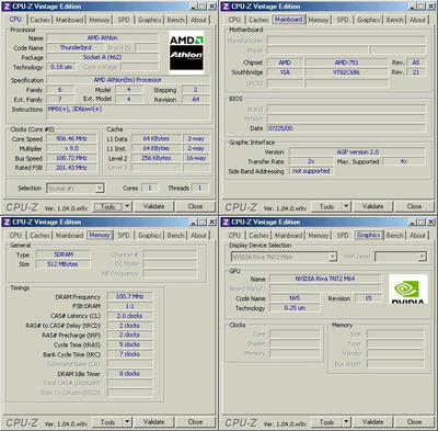

Finally, I collected scores using my TNT2 M64, the weakest discrete video card that I own! (I thought that my Ironbridge system had a Voodoo 3 3000 AGP in it, but that card must be in my 440BX system right now.)
164.36 KiB
996 views
43.67 KiB
996 views
49.39 KiB
996 views
I don't know why 3dMark2001 reports that I didn't use the default benchmark settings. I didn't change any settings; I simply started the program and clicked the first button that I saw with the word "benchmark" on it, so nobody accuse me of cheating, please!

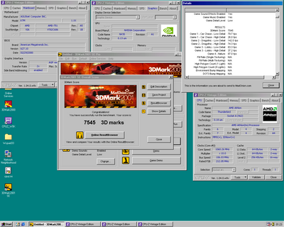

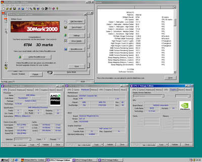

Reply 55 of 78, by paradigital
Well my K7V tops out at 105MHz FSB. 106 crashes out of 3DMark unfortunately. My 900MHz Thunderbird won’t boot with a 10.5x multiplier, so 1050MHz is my limit.
All that’s left to try now is a different GPU.
Scores with the FX3000 below. Both run using 56.64 and DX7a for 3DMark2000 and DX8.1b for 3DMark2001SE.
101.47 KiB
775 views
151.56 KiB
775 views

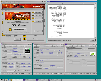

Reply 56 of 78, by paradigital
Seems that I was too quick to judge 106FSB. 3DMark2000 crashes on 106, but 3DMark2001SE doesn't. Squeezed another few points out of it. Apologies for the CPUz layout, I didn't expect the run to complete so hadn't arranged the 3DMark window to somewhere useful before it was too late.
158.49 KiB
757 views

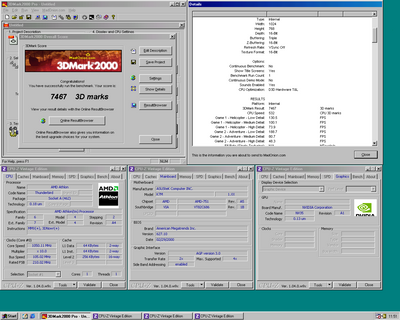

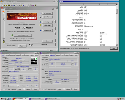

Reply 57 of 78, by paradigital
Got a few hundred extra points in 3DMark2000 by switching out to a slightly older GPU in a Geforce 4 Ti4800SE. I wanted to try my GF3 but it's apparently died in storage and needs a RAM transplant.
This allowed me to drop to 45.23 driver version which appears to have a bit less of an overhead. I did have to back off to 104FSB though 🙁
79.1 KiB
687 views

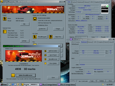

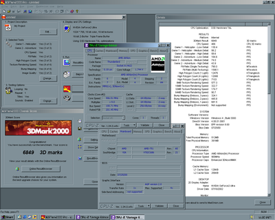

Reply 58 of 78, by STX
paradigital wrote on 2023-10-21, 06:24:
...What Nvidia driver version did you use?
30.82
supercordo wrote on 2023-10-21, 10:41:
Can you please add screenshots using the print screen button?
I ran the benchmarks again to create full-screen screenshots and got slightly higher scores.
94.73 KiB
673 views
STX's new 3dMark2000 high score: 6849
171.62 KiB
673 views
STX's new 3dMark2001 high score: 4936

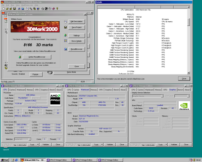

Reply 59 of 78, by paradigital
No idea why, but on a whim I downgraded the BIOS on my K7M from 1013.002 to 1009 (from The Retro Web). This appears to have made the board much more accomodating to FSB increases, getting into Windows at up to 116FSB, but not quite stably.
115 x 9 works, managed to get 8039 points in 3DMark2000.
115 x 9.5 didn't run 3DMark stably.
114 x 9.5 did, which has resulted in my highest 3DMark2000 score so far:
105.03 KiB
642 views
