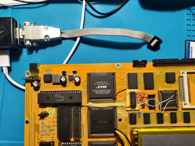

Reply 183 of 393, by n0p
GloriousCow wrote on 2023-09-11, 22:49:
The Book8088, even with an 8088 CPU, isn't quite 100% cycle-accurate to an IBM PC. Can we fix that? Well, yes we can!
https://martypc.blogspot.com/2023/09/hacking- … r-accuracy.html

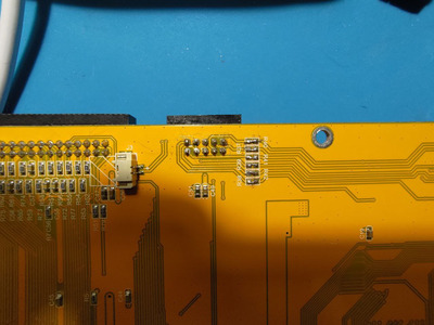

Since i needed to fix my Book anyway, i've made this to my Book and it works 😀
https://www.youtube.com/watch?v=xbypwpFnjkY
So now we have two working hacks:
CGA disconnect for Book V1 by Sergey https://forum.vcfed.org/index.php?threads/boo … -2#post-1334871
and
DMA refresh fix by GloriousCow

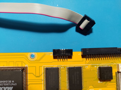

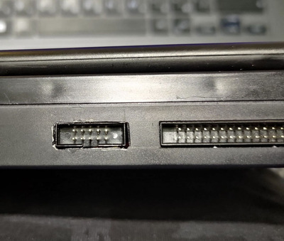

And i still think we can connect external display here (not my best job, but anyway)
Connectors are called BH2-10R (board side), IDC2-10 (cable side) - this will save you some time searching.

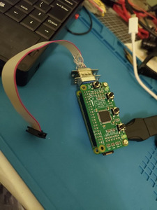

Reply 184 of 393, by n0p
RGBtoHDMI adapter works 😀
Good: finally external monitor can be connected.
No so good: Composite emulation is not nice, but as that opensource project, the problem could be addressed 😀
There's some additional blanks after mode change, maybe some kind of calibration kicks in.
Bad: End effects of Area5150 are not emulated, but it does show some stuff where line shifts supposed to be, so that might be the problem in the Book CGA implementation.
Anyway, my first problem is solved. proof in video link:
https://www.youtube.com/watch?v=RcgZizeQVp0

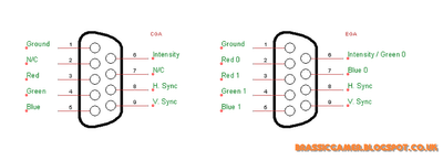

Cable is using female DB9 to plug into RGBtoHDMI directly.
Pinout for CGA is taken from internet search, 10-pin connector is in Book8088 design pdf.
Worked from the start, it usually doesn't happen that way.
Edit: I'm too inattentive. RGBtoHDMI documentation states you need Zero 2W to use CGA artifacting and i've used simple Pi Zero. Glad those exist here.
Edit2: Some time ago i got PEGA 2A EGA card really cheap ($10). Now with RGBtoHDMI i could test it - first in Pentuim build ISA slot. Worked! Though RGBtoHDMI has some struggle syncing to it, but picture after sync was great - tested with Bad Street Brawler. Next, inserted it to ISA expansion and connected to Book8088, disabling CGA. No go, card not detected. BUT, if i enable CGA again, it starts to show some garbled, but recognisable picture. It's ports somehow not detected on ISA (i'm using crtc ports detection with cursor positioning in BIOS), but some interception happens. Given that PicoGUS also didn't work in my Book8088 - failing at control port IO, i suggest either my one has problem with ISA extender connector (extender itself works fine, i've used PicoGUS with Hand386 w/o problems, perfect), or V1 has some problems interfacing external devices - build-in ISA devices: CGA, CH375, Adlib, XT-IDE work fine.
Edit3: Added more photos
    157.83 KiB
    1812 views
    Connector solder side and jumper wires
    268.28 KiB
    1812 views
    Finished cable, DMA refresh hack, CGA disconnect hack
    156.42 KiB
    1812 views
    Connector
    96.04 KiB
    1867 views
    Pinout

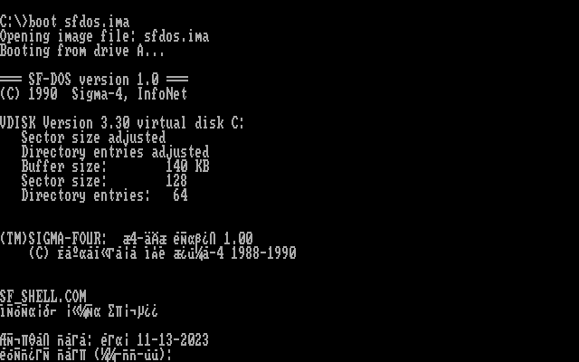

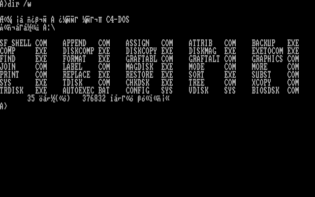

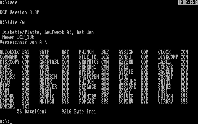

^For authenticity, there's the DOS for the Poisk-1, SF-DOS ('Sigma Four')..
Poisk was a series of eastern PC compatibles.
That DOS should be on MS-DOS 2.11 or 3.x level.
Alternatively, there's the East German DCP in version 3.20/3.30.
The Disc Control Program uses latin characters/filenames, at least.
So if you got the German language version, you're not totally screwed.
That being said, learning cyrilic alphabet isn't that hard, either.
It's worth a try, if free time permits it.
PS: For really, really old school fun, AlphaDOS might be an option. It's non-English, though.
See https://pikabu.ru/story/pp_yevm_es_1841_6484535
Edit: https://en.wikipedia.org/wiki/ES_PEVM
Edit: Picture attached.
    4.3 KiB
    1588 views
    4.4 KiB
    1588 views

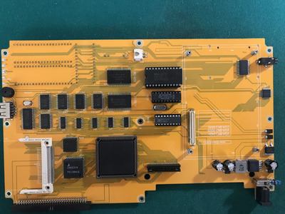

Reply 190 of 393, by n0p
Errand wrote on 2023-11-13, 07:03:
Jo22 wrote on 2023-11-13, 00:37:
^For authenticity, there's the DOS for the Poisk-1, SF-DOS ('Sigma Four').. Poisk was a series of eastern PC compatibles. That […]
Thanks!
I was considering trying those, but Book8088v2 has another CGA card and I probably won't be able to flash CGA-bios - so, I'm out of luck with CP866... 🙁
That's a socketed EEPROM chip there, that's good. It seems to be 64K (i might be wrong), that a bit of overkill, but anyway.
Make a dump of it first, next, create a file that will contain cp866.bin four times (i've no idea how exactly it addressed, but i doubt anything except card layout is really changed) and flash it. Should work, and you can always flash it back with original dump. https://github.com/jinshin/Book8088/
And i know what Poisk-1 is too good 😀 I salvaged chip from it's board.
Emulated CGA text mode, oh joy.
Can someone share original BIOS dumps for Poisk-1, my board somehow doesn't have those now 🙁

I’ve made some photos of v2 board while disassembling:
1.91 MiB
1390 views
Looks like no more external display out.
What surprised me is the text underneath the video board: 'VGA-BK3-9000i'… Isn’t it what I’m thinking about?.. 😀
