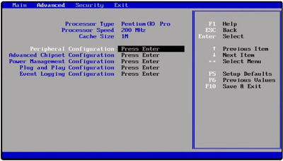

Reply 3 of 21, by PC Hoarder Patrol
Deano wrote on 2023-11-11, 15:41:
Just got a AP440FX system without CPU, wondering it I should go for a Pentium Pro 200Mhz with 1MB Cache or not. The 1MB are more expensive and not sure if it has compatibility issues (motherboard manual only says up to the 512K version but probably was made before the 1MB came out).
Anybody tried that combo or seen any benchmarks between the 512KB and 1MB CPUs?
The 1MB Cache part seems to work without issue - https://www.youtube.com/watch?v=0Oxe5I1Urks
"I didn't set anything on the motherboard, I put in the cpu and it worked."
The attachment AP440FX PPro 200_1M.jpg is no longer available
