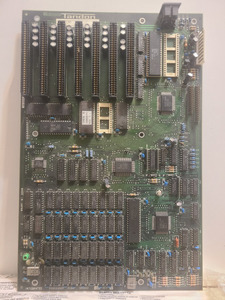

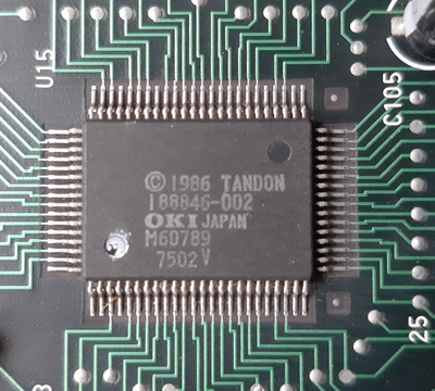

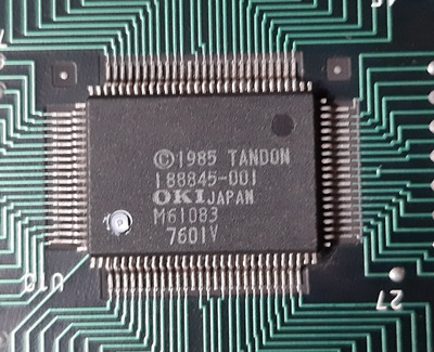

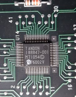

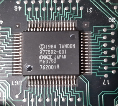

Hello everybody,
I have this XT motherboard without the bios chip, does anyone have the same board so they can share bios file ?
Or a bios that can at least test the motherboard to see if it is alive.
https://theretroweb.com/motherboards/s/tandon … on-model-188840
Chipset : see images below
Thanks in advance
    916.99 KiB
    1482 views
    1.42 MiB
    1482 views

Reply 2 of 21, by bobconan
SDumas wrote on 2023-11-03, 16:25:
Does anyone have this board?
I would appreciate any help to at least test this motherboard.
SDumas

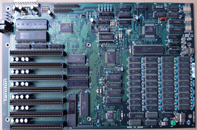

I have one. Dont know it's status. I also dont have a eeprom reader. Its also a 001 rev g

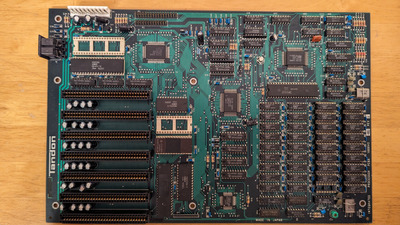

Reply 4 of 21, by jcmb
SDumas
Hi SDumas,
I do have a "001 REV G" board - found it on the curb about two months ago. I didn't have the opportunity to test it yet but may have managed to read out the 16K EPROM.
A hexdump of the attached BIOS file indicates that it's version 3.2/3.28 from April 29th, 1986.
Best regards

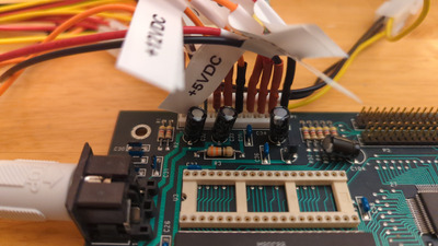

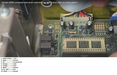

Do you have the original power supply for this motherboard?
It is necessary to pay attention to the pinout of the connector because it is not standard.
See attached photo.
If necessary, I can provide the pinout to make an adapter from an AT power supply.
Best regards

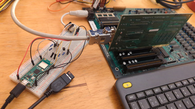

Reply 8 of 21, by jcmb
Hey SDumas,
that's great news and you're welcome. 😀 I'm glad I could help so far.
Here are my thoughts on a planned hardware setup. If you could just post yours as well, that'd be extremely helpful. Thank you!
Power supply:
I did find the power connector's pinout in some reddit post and verified by the very same YouTube video from your screenshot. 😁
I'm thinking about using a picoPSU for testing and sacrificing an ATX connector to directly attach the corresponding supply lines.
Graphics adapter:
I have a 1990-ish era 16-bit ISA VGA card but I'm unsure if that would do the trick.
It's an Oak OTI-077 and I'm unaware of compatibility with the shorter 8-bit slots (or even the architecture as a whole).
Lack of XT keyboard:
I think any (cheap) micro controller solution plus some breadboarding "magic" would manage.
For example there is a promising one on GitHub using a RaspberryPi Pico.

If anyone needs the pinout for the power connector of this motherboard, I'll put it here anyway...
See the photo attached:

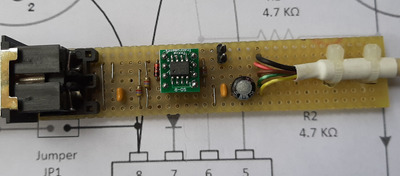

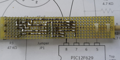

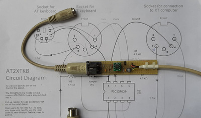

I found a AT to XT adapter that will solve the lack of the XT keyboard.
The first link is for Microchip PIC12F629, the original one.
The second link is for PIC12F675.
https://www.minuszerodegrees.net/at2xtkb/AT2X … onal%20info.htm
https://www.mattmillman.com/building-an-at2xt … rototype-board/
Note1 : The code is different for each of the uC.
Note2 : The hardware is the same, so you can use PIC12F629 or PIC12F675 without any change on the PCB.
I'm going to make 2 units myself and I hope it solves 100% the problem of the lack of a true XT keyboard...
Reply 11 of 21, by jcmb
Hey SDumas,
thank you, this looks like a descent and hazzle-free solution to the keyboard problem.
After fiddling with the PSU connections and testing the voltages beforehand I'm also happy to report that my board is alive as well.
The Oak VGA card does work in a 8-bit slot.
For XT keyboard replacement I went with the RPi pico variant from said GitHub project (had a pico at home anyways). It seems to work very well even with wireless USB keyboards.
Right now I didn't get any further than POST and some error message afterwards but at least ESC and CTRL-ALT-DEL is working perfectly. 😁
I'm going to investigate further the board's floppy controller capabilities (double density should work) and report back afterwards. I also ordered additional compatible EEPROMs for tinkering.
Best regards

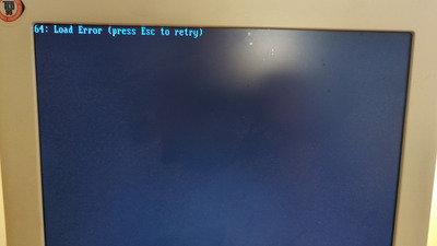

I realize now that you have the same error as I did on the boot screen (error 64)
But before that the RAM count stopped at 384K Bytes. I don't know if this is the correct behavior.
How was it in your motherboard ?

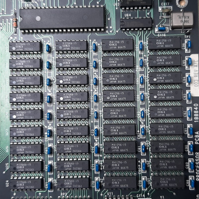

Reply 13 of 21, by jcmb
Hi SDumas,
I believe the error code is expected. The RAM check on my model runs every time on cold boot then completes and shows the error message. Maybe due lack of BASIC ROM (not integrated in the 16K EPROM as opposed to IBM 5160's 32K ROM) and/or boot drive. But at least a speaker connected to JP9 sounds a nice short beep on bootup. 😀
At first it only passed 128K since memory bank 3 was missing a parity chip. Starting from the leftmost bank the memory has to be coherent. Switched it over from bank 4 and now I got a juicy 192K!
As far as I can tell from the initial pictures your board's slotted chips are OKI M41256A. 8*32K each = 256K per bank 3 and 4 -> 512K.
The soldered amount is 128K the maximum is 640K. So I guess there's either something wrong with a component on bank 4 or some solder joint or jumper connection yet to be opened/closed. Maybe try reseating the RAM chips...
Bingo! Got the same results as you from my research! 😀
Yours is probably even a TM6005. Hence the "higher" board model (003) than mine (001), maxed out 640K "OKI" branded RAM and an 8Mhz Intel D8088-2.

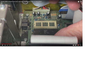

Some interesting news to me is that the Tandy 1200 is again a clone of the Tandon.
https://www.reddit.com/r/vintagecomputing/com … comment/dsppapq
https://youtu.be/oSDtnQMUBeQ?t=279
Given that is true it could become valuable info regarding this guy's findings on the weird floppy controller connector:
https://youtu.be/oSDtnQMUBeQ?t=171

Reply 14 of 21, by jcmb
SDumas wrote on 2024-06-09, 18:31:
Just compared your screenshot and mine and realized your JP1 wasn't set.
Out of curiosity I removed mine and now I also get a strange RAM check until 384K even though the system only has 256K.
Not a 100% sure about the background but try putting a jumper on JP1 and you should receive a whopping 640K with your current setup.
Reply 15 of 21, by SDumas
jcmb wrote on 2024-06-09, 22:27:
Just compared your screenshot and mine and realized your JP1 wasn't set. Out of curiosity I removed mine and now I also get a st […]
First I have to correct an error:
I said that pin 1 of Floppy connector was close to the power connector, but it's the opposite, the information
on the bottom layer is misleading, the square pad is actually on that side but is wrong, for the parallel port
it is correct.
With JP1 set, i have a count of 192KB.
In your motherboard photo you have 4 banks of 64kB each, total of 256KB, the MSM3764A chip is 64K x 1-bit.
I think my calculation is correct...
On my motherboard i have 2 banks of the same chip, plus 2 banks of 256KB x 1-bit (MSM41256A), so i have
128KB + 512KB = 640KB.
In my motherboard all chips ara soldered to the PCB.
See on the photo attached.

I found the XT keyboard, but I also made an adapter and it worked fine.
It will be with this that I will do all the tests from now on.
I leave here the photos of the adapter, the uC was the PIC12F675.
For now, I can say that it works very well, even through a KVM switch.
Regarding the RAM memory problem, I verified that the address lines goes to the U14 chip through the 74ALS244 - U75 (Octal 3-state Buffer/Line Receiver).
I checked all these address lines and didn't find any problems, they all had activity.
I suspected that one of these lines might have problems, but I didn't find anything suspicious.
Chips MSM3764A and MSM41256:
Pins 2 and 14 Din an Dout (data lines)go to Chip U15 - 9 lines, one for each line
Pin 4 (RAS) go to chip U14 - 4 lines, one for each column
Pin 15 (CAS) go to chip U14 - 4 lines, one for each column
Address lines (A0 to A8) goes to U14 through U75 (74ALS244)
Pin 3 (WE) common to all RAM chips
So far I haven't found anything that could cause that wrong RAM value.
Regarding the chipset, I can't find any information, no datasheet to be able to diagnose the fault.
    638.77 KiB
    921 views
    566.13 KiB
    921 views
    595.82 KiB
    921 views

I ordered a replacement for the missing parity chip and got a full 256K of RAM afterwards, then upgraded to 640K with a handful of NEC branded ones.
The missing dip switches is a real bummer. Tandons decision about its omission confuses me a lot.
What I found out so far:
JP3&4 might set graphics mode (at least with GLaBIOS I'm getting different results showing either VGA BIOS info or not). Compare http://dosdays.co.uk/topics/xt_dip_switches.php.
JP5 toggles the parallel port on/off

I don't know what I'm going to say, but this is a very weird motherboard...

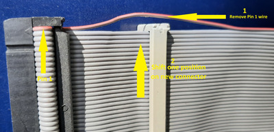

When connecting a floppy drive, I noticed that there was no activity, nor did the LED light up when trying to boot.
I decided to check with the multimeter and found that the 2 rows of pins were swapped,
and anyway contrary to what I said before, pin 1 is after all, near the power connector.
This video explains (your link some posts above) :
After all, this video explains the problem, at first I didn't really understand it, and after looking more closely, I saw that it was exactly the same problem as this motherboard.
The change to be made to the flat cable is shown below.
Now I have the floppy drive trying to boot.But the RAM count stop at the same value (384KB).
