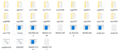

Currently working on the idea of "Service Pack".
I have 19 update packages, which each will have capability to install and uninstall. Mostly it is replacing files, but some updates patch existing files or change lines in *.ini files.
If i would find some easy text mode UI with checkboxes, i could create a nice view to choose, which updates you want to install... Suggestions?
Quick picture of current WIP service pack folder - total size is around 2MB right now. (the 7z.exe will not be part of package, i use the unzip.exe from Info-ZIP)
