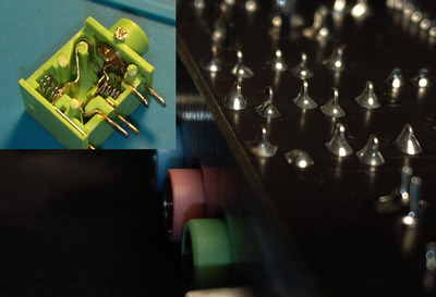

Thought I share my findings here in case someone else will encounter similar issue. My card as it turned out arrived with defective 3.5mm line out pod.
I have been using my card exclusively over digital out. However over holidays I decided to hook it up to my external analog amp. I was confused why 2nd reality playback in SBPro mode was in mono...
Long story short. It looks like one of the 3.5mm channel pin was improperly pushed in during assembly as you can see from attached picture. Also I found small square piece of metal inside pod also visible on pic.
Well I decided to save some CO2 emissions (+ Keropi time) and made repair myself. I "manhandled" pin back to correct position and now it seems to working as intended. So it's all good now.

oh wow , I did not notice that during testing... sorry for this!
nice save though!! 😁
if anyone faces a similar issue and wants replacement jack(s) just let me know!
probably on whatever next board we make we won't use this type of jacks but in order to fit any other kind it would mean that the MIC one will have to go only be available through AC97 header

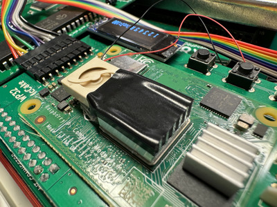

Just want to say that this card, with PCmidi add-on and McCake WB module, is absolutely effin' brilliant.
My 486slc2 has this combo and a GUS PnP and it's just .. a dream.
Thank you!
(Had to attach some pics.. the mt32 gets a bit hot so I added the tiniest fan I've ever seen ;) )
