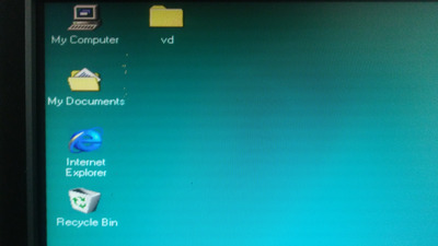

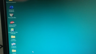

Hi everyone so i ve voodoo rush card trying use it with slot 1 motherboard pentium 2.
Using windows 98 but screen keeps flickering after windows 98 opening. Using true drivers but still flickers
Reply 1 of 23, by rain
Its flickering only desktop , not in games
Reply 2 of 23, by rain
Any suggestions ":

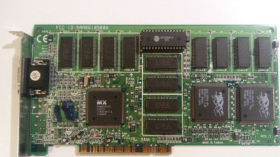

Rush cards werent exactly a good product. Both Macronix and Alliance Semi chips came straight from garbage dump, failed chips with no market presence on their own. Macronix was actually making VGA chips from around 1992 https://www.vgamuseum.info/index.php/news/ite … national-co-ltd yet you never see any in the wild, I think Rush killed their ambitions 😀 Alliance chip was straight up broken, and Imo selling it constituted fraud.
Its possible mx86251 "160MHz Ramdac" is just that bad quality.

So, the 2D chip on the Rush can either be from Alliance or from Macronix. I know for sure that the drivers for the Alliance version are overclocked on the 2D chip by default and that can cause some graphics corruption in Windows.
My card has the Alliance chip, so I can't be too much help since it looks like you've got the Macronix. But you might want to double-check that you're using the Macronix version of the drivers. And then maybe also look into whether there might also be overclocking issues on the Macronix chip, but that would just be a shot in the dark.
