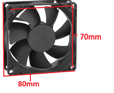

Apologies for this silly question, just want to double check before I order the wrong thing.
I have an old PC case from 1998 that has screw holes for fans that are 70mm apart. Can you assume a 80mm fan has 70mm screw holes?
I'm assuming the measurements are like the following?

The standard mounting hole C/C for 80mm fans is 71.5 mm, so I'd suspect a measurement error, but that's close enough even if your measurement is correct. You can always use M3 screws and nuts if the hole pattern is too tight for fan/M4 screws 😀
Reply 4 of 5, by Horun
Yes they measure fans on the outside, those usually use those "coarse threaded" M4 type screws that come with said fan but not always...
Reply 5 of 5, by Jo22
There are some alternatives to these screws.
Someone can use these rubber "screws" that were used by noise silencing kits.
