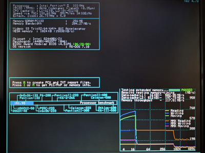

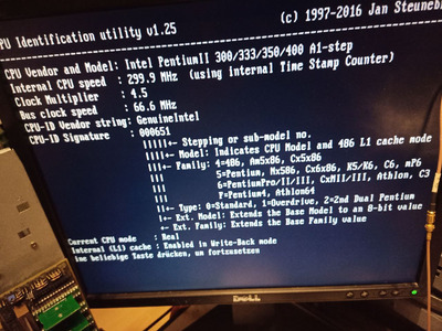

I have 5 Pentiums II 300 MHz SL2YK / SL2W8. They are all locked and can do 450 wih L2 on 100MHz FSB.

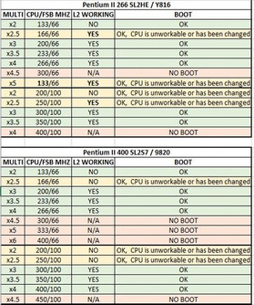

Regarding unlocked PIIs, I recently did some testing on Abit BH-6 wih unlocked 266 Klamath and 400 Dechutes:
70.59 KiB
1014 views

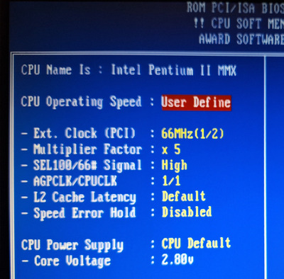

Bios reports "CPU unworkable" on some multipliers. This warning can be avoided by setting "Speed Error Hold" to Disabled:
1 MiB
1014 views

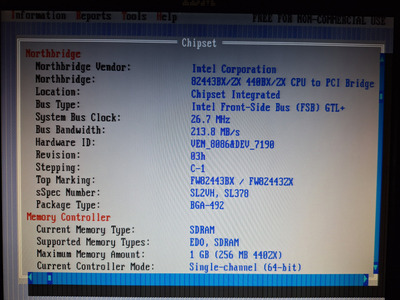

Multiplier x5 on Klamath acts funny reporting 5 x 26.73 (FSB), but L2 is turned on:
1.96 MiB
1014 views
1.58 MiB
1014 views
Tested also on Asus P2B, same behaviour.

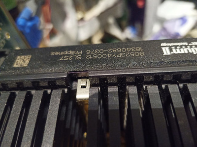

information with production weeks ( after 1998/31 is locked) is wrong.
My unlocked deschutes is from 1998/34

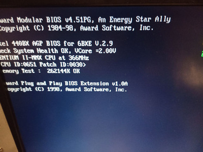

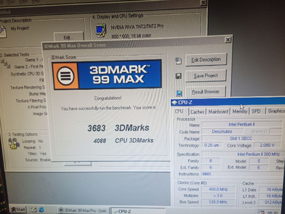

and i have drived this deschutes hard (GA 6BXE is weakpoint): 3x133 Mhz for 400 MHz Shootout
182.8 KiB
835 views
5.5 Multi, POST successful, but not booting from harddisc/floppy
I've found another date code on Slot 1 PCB (inside SECC cartrige).
Maybe that one is more important, than found on the SECC. It's only my assumption, they can differ. Maybe not.
So that's why you can have datecode 1998/34 (but maybe inside is 1998/31 and that's why it's unlocked)
In this case, the outer one (on SECC) is not important, but inner one.
194.06 KiB
835 views
