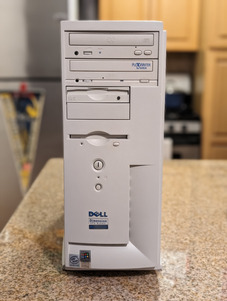

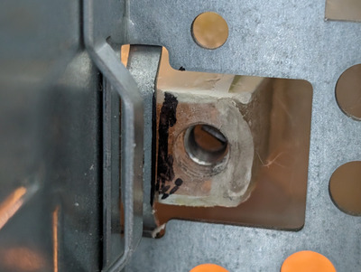

i did a little case repair on my dell xps b100r front bezel.
the middle and lower tabs on the right side were both broken when i first acquired.
to repair, i broke the rest of the tabs completely off.
filled with 2 part expoxy.
hit it with the dremel.
drilled, tapped and inserted helicoil insert.
it did the trick and i can still remove the bezel it if needed.

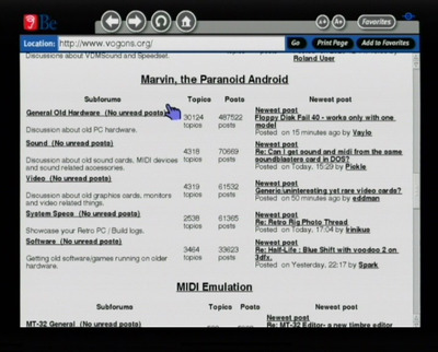

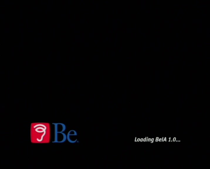

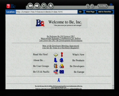

Some light internet browsing using an Internet Appliance, or rather the system itself (BeIA) on another thin client after some editing.
Couldn't log into vogons sadly.
