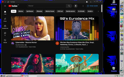

Reply 203 of 257, by theelf
Good news!!!!!!! Chromium 121+ on XP!!!!
https://github.com/win32ss/supermium
At least in my 2 XP machines, XP x64 desktop and XP 32bits laptop, super stable, no problems for now, about e xtensions, i only tested ublock origin no problem works fine
WOW even web app works!!!

Thanks for the info.
Any clue about system requirements? It crashes in an old laptop with Windows XP SP3, Intel Atom N280 and 1 GB of RAM.
The newest web browser I am able to run in this computer is bnavigator.

I think similar to chromium in real world usage, exept supermium in 32bits build ask for SS2, and chromium SS3
Right now im testing in a i5, 16GB ram, 256SSD, Windows XP SP3 32bits, and work great, no difference to use chromium in linux/win10
