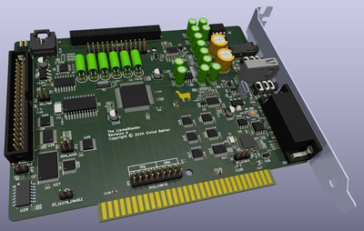

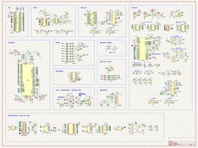

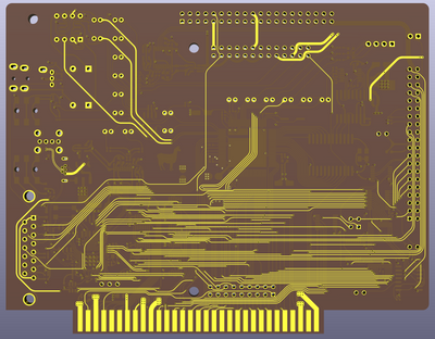

Reply 33 of 60, by Eivind
Schematic and component selection done, currently doing layout and routing...
305.53 KiB
800 views
275.8 KiB
800 views

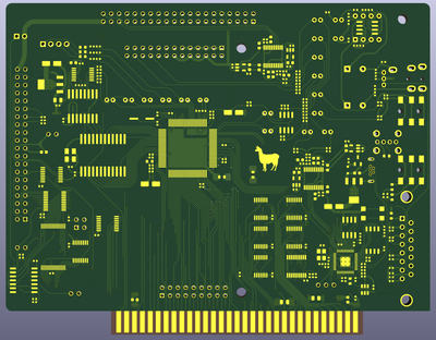

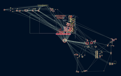

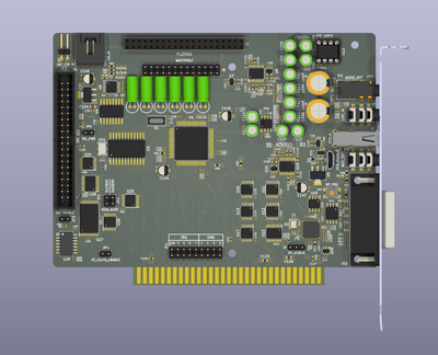

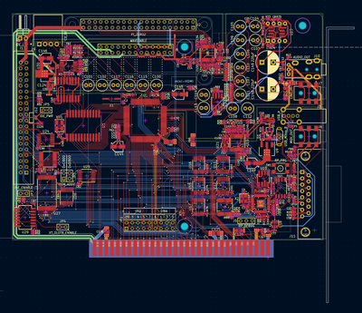

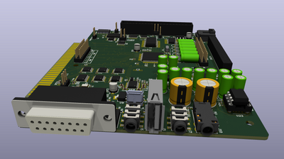

Reply 34 of 60, by Eivind
Nearing completion of the first prototype:
577.36 KiB
730 views
1.03 MiB
730 views
1.78 MiB
730 views
1.34 MiB
730 views
The LlamaBlaster sound card
ITX-Llama motherboard
TinyLlama SBC

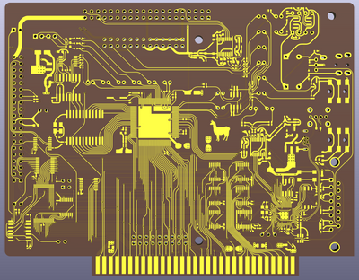

Reply 36 of 60, by Eivind
Tried experimenting with rounded traces, I think it looks cool:
614.66 KiB
613 views

Almost ready to order the first prototype batch now.

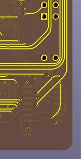

Reply 37 of 60, by MJay99
Indeed, looks great! And you're mighty fast in your project! Took me weeks to finish my card two years back.
I actually also tried converting my version into rounded tracks a few weeks ago and that instantly made the DRC and Kicad crash. That issue has been fixed by now, though 😀
On a side note, is DRC ok with this part (that bend on the right, middle side)?
It looks like it might violate the minimum spacing you're having everywhere else ->
11.78 KiB
601 views
Reply 38 of 60, by Eivind
MJay99 wrote on 2024-02-19, 10:43:
Thanks! I ran the "Round Tracks" plugin (from https://github.com/mitxela/kicad-round-tracks), and it worked pretty well! Had to touch up and adjust like 50 or so tracks that violated the DRC, but it didn't take that long. The (relatively) new "Fillet tracks" option in Kicad is awesome, gone are the days of making or adjusting hundreds of tiny line segments in order to get a smooth curve!
Yep, I've set a minimum track clearance of 5 mils - what you're pointing to there resolves to 5.92 mils, so no issues. 😀

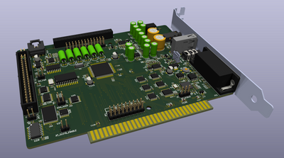

Reply 39 of 60, by Eivind
First prototype batch is in production. I had to do a cancel+re-order because JLC doesn't like the trace clearance to be <0.15mm if there is less than 30% copper fill on a layer - which is weird and undocumented. But I got it sorted in any case.
Here's a render of the prototype:
741.29 KiB
532 views

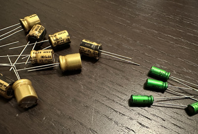

...also, got a couple of nice bags o'caps in the mail this morning:
1.52 MiB
532 views
Now I've gotta make a suitable 3D-printed bracket.
