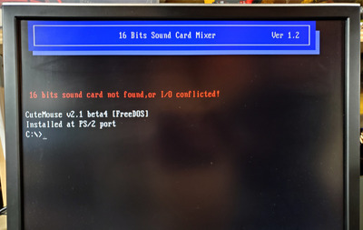

I was recently trying to use the MK8330 with a DFI ITOX G7S620-N-G motherboard (Intel 865G chipset). Unfortunately the card fails to be recognized by system.
I confirmed the card works by testing with a Pentium MMX 200 system (Intel 430TX chipset). But it won't work with the DFI / 865G motherboard.
I tried disabling a bunch of I/O devices in the BIOS and reserving a handful of IRQ and DMA channels, but to no avail. The test program included with the drivers fails even with just the I/O address.
I have used other ISA sound cards with this motherboard including Orpheus I / Orpheus II, AWE64, GUS Extreme, Yamaha Audician 32 and the PicoGUS. No issues with those cards.
Not sure if this card is just incompatible with this board and/or chipset. Or if there is potentially something else I could try to get it to work.

weird , CMI8330 was used in value-oriented mobos up to pentium3 era
must be a chipset/bios combo incompatibility for some reason or the CMI drivers crapping out?
is the card listed on boot?
what does unisound say?
🎵 🎧 MK1869, PCMIDI MPU , OrpheusII , Action Rewind , Megacard and 🎶GoldLib soundcard website

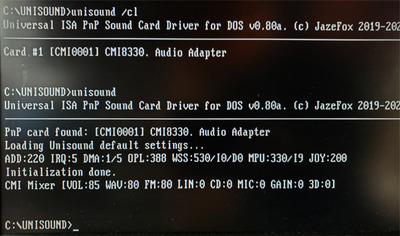

Tested the MK8330 again tonight.
The card isn't listed on boot, although I don't think any ISA card gets listed by this BIOS on this motherboard.
I tried it with Unisound and the card was detected and initialized. Tested it with a few games including Duke 3D, Dynablaster, Ultima 7, and Crusader: No Remorse and they all worked. Crusader in particular worked with the SB16 option.

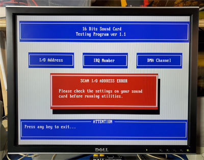

However, trying it again with official drivers and those once again failed to detect and initialize the card. 😒

so it's the CMI driver that fails for some reason... better than a hardware incompatibility! 😁
