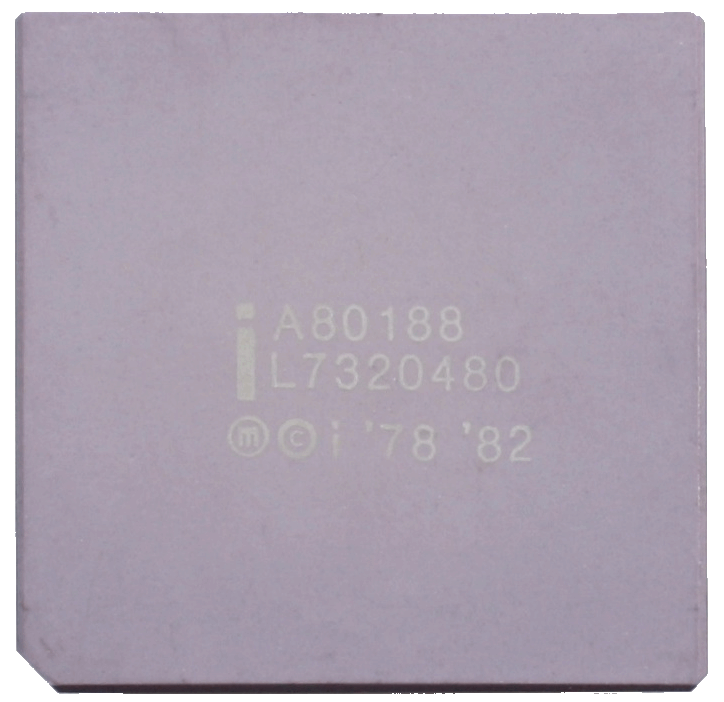

First post, by yevrowl
Please tell which computers were produced with an 80188 processors.
https://www.cpu-world.com/CPUs/80188/index.html

Reply 2 of 19, by rasz_pl
Anyone with half a brain cell designed with something more sane like NEC V.xx line.
Reply 3 of 19, by Jo22
SBC-188 ?
Back in the day, likely no one would have been chosen the 80188 for a DOS PC, though.
The reason is simple, really.
What made the 80186 attractive was a) the higher performance x86 core b) the integrated peripherals.
The 80186 thus was nice for embedded systems or fast DOS PCs.
The 16-Bit memory access was much more performant than that of an 808x, also, I believe.
If IBM compatibility wasn't so important, the 80186 could be used as-is.
If it was important, the internal peripherals were being bypassed and the 80186 was solely being used for its x86 processor core.
Computers which used the 80186 were (among others):
- BBC Master 512 (an upgrade for BBC Master 128)
- Tandy 2000
- Siemens PC-D
The 80188 by contrast isn't better than an 8088, besides having an 80186 instruction set.
It has same 8-bit bottlenecks as an average XT.
The newer CPU core might process certain instructions in fewer cycles, though.
All in all, the 8018x is like an 80286 which had traded its MMU and Protected-Mode for integrated peripherals.
One thing useful that it has, though, is the ability to handle NMIs, maybe.
An x87 emulator like EM87 or an 80386 emulator (-Real-Mode instructions only-) like EMU386 might technically run.
Edit: I assume that the 80186 went out of favor when the regular 80286 was being available for a fair price.
In embedded use, it was still nice to have, though.
The 8018x series could be used as on-board controllers on ISA cards, for example.
Say, for an HDD compression co-processor card. Or as the main controller of an IDE caching controller. Things like this. 🙂

Reply 8 of 19, by mkarcher
Jo22 wrote on 2024-03-08, 10:30:
Not exactly. The 16-bit memory access of the 80186 is just as slow as the 16-bit memory access of the 8086. For accessing word-sized data, it's obviously still faster than the 8-bit access of the 8088, though.
That's also the key issue with the 80188 mentioned in the title of this thread: It is widely known that the 8088 in typical IBM PC software is oftentimes limited by the bus perfermance, because it can execute instructions faster than it can fetch the instructions using the 8-bit bus interface (that's what you get when you slap an 8-bit bus interface onto an execution unit that was designed with the twice as fast 16-bit bus interface unit in mind). The faster execution unit in the 80188 only provides minor performance improvements in most cases, because it will just be idling around longer waiting for the next instruction to be fetched. The 80188 only makes sense if you specifically make use of the new features it provides:
  • Integrated interrupt controller, timer and device addressing decoder, but those integrated peripherals are not IBM PC compatible.
  • The new "286 real mode" type instructions, that allow smaller code, so less time is "wasted" on fetching the code. Instructions that allow reducing the code size include the new ENTER/LEAVE instructions for procedure entry/exit code, the possibility to push a constant to the stack without loading it into a register before, shifting by multiple bits at once wihout loading the count into CL before or repeating the shift instruction.
  • Perform burst I/O using the new repeated I/O-to-memory instructions like REP INSB/REP OUTSB (or the corresponding word instructions, although they make more sense on the 80186 than on the 80188). As the 8018x processors are still using the quite slow bus implementation of the 808x processors, REP INSx/REP OUTSx is likely outperformed by any kind of sensible DMA controller, though. As the 8018x does not include an integrated DMA controller, REP INSx/REP OUTSx might still be interesting for embedded applications in which the REP INSx/REP OUTSx is sufficient, because these instruction beat a loop containing IN/STOS still by a considerable length.
So you can clearly see some embedded applications in which the 80188 makes sense, but its use as general-purpose IBM PC comatible processor is limited. One application of the 80188 processor is the Tekram DC-600B caching IDE controller. The actual IDE hard drive data on that controller is moved using external logic, so the limited I/O performance of that processor is not relevant to that application.
The 808x already have NMI support. IBM used the NMI support on those processors to report coprocessor traps (Intel did not provide a standard way for coprocessor traps on the 808x), for memory parity error reporting. You are thinking about the "coprocessor not present" exception and the "invalid opcode" exception, not the NMI.
Most of the Tekram DC-6x0 series are based on the 8018x processor. The later ones are based on the 80186, and only the earliest ones use the 80188. The newest generation (DC-680C, DC-680CD, DC-690) made the step up to the 80286. Also the Compaq IDA ("intelligent drive array") controller, an 8-drive IDE RAID controller, is controlled using an 8018x. Again, just as with the Tekram controllers, the 8018x processor does not touch the drive data, but only controls the logic that transfers the data at way higher speeds than the 8018x could handle. The "spiritual successor" of the Compaq IDA ist the Compaq SMART SCSI raid controller - and while that controller uses a 486SLC as core processor, it is mostly based on the same technology as the older IDA controller, and does not use a lot of functions of the 486SLC that exceed the capabilities of the 8018x processor.

Reply 10 of 19, by mkarcher
Jo22 wrote on 2024-03-10, 11:21:
I didn't know that, just checked my old books because I found this topic interesting. […]
mkarcher wrote on 2024-03-09, 11:50:
As far as I understand, the 8018x CPU cores were closer to 8088/8086 than 80286.
That's a bit disappointing, to be honest. I always assumed the 80186 was more like a cut-down 80286.
Both is correct in a certain point of view. The 80186 combines an 80286-like execution unit with an 8086-like bus interface unit. Or, put it another way: Moving forward from the 8086 to the 80186 we got a new execution unit, and stepping up to the 80286, we also got a new bus interface unit.
On the bright side, though, one book says that the 80186 did at least manage to do dedicated address calculation. […]
Because, that was one of the main shortcomings of the 8086 vs 80286. Or so I think.
The 8086 had to use its ALU for this task, if memory serves.
Though of course, this didn't fix the slow 8086 style BIU as such. Actual information exchange was still slower than on an 80286.
The 16-bit offset is calculated inside the execution unit, the bus interface unit is responsible for adding the segment register contents to the offset provided by the execution unit. You are right: The 8086 execution unit used microcode and its single 16-bit ALU to do the address calculation, while the 80186/80286 execution engine got its own AGU ("address generation unit").
Furthermore, while the 8086 bus interface unit was slow, it was not terribly slow. The 8088 was the processor that suffered severly from the bus interface unit, because the execution unit executed instructions at the same pace as the 8086 did, but the bus interface unit only provided half the bandwidth to fetch those instructions, introducing a severe bottleneck. Combining the 8-bit BIU of the 8088 with the improved EU of the 8018x is a recipe for mediocre performance, though.
Regarding the fetching bottleneck, that one was so severe that Intel had to acknowledge it in the official data sheets!
8088 datasheet wrote:
The CPU is also limited by the speed of instruction fetches. This latter problem only occurs when a series of simple operations occur. When the more sophisticated instructions of the 8088 are being used, the queue has time to fill and the execution proceeds as fast as the execution unit will allow.
80186/80188 datasheet wrote:
The 80186 has sufficient bus performance to ensure that an adequate number of prefetched bytes will reside in the queue (6 bytes) most of the time. Therefore, actual program execution time will not be substantially greater than that derived from adding the instruction timings shown.
The 80188 is noticeably limited in its performance relative to the execution unit. A sufficient number of prefetched bytes may not reside in the prefetch queue (4 bytes) much of the time. Therefore, actual program execution time may be substantially greater than that derived from adding the instruction timings shown.
Note how the datasheet acknowledges that the 80188 may be stalled on instruction fetches much of the time. As vendor datasheets are typically making the chips appear in a good light (as you see in the 8088 datasheet, referring to the execution of complex instructions allowing to fill the queue), the statement about the 80188 shows that Intel completely gave up trying to paper over the insufficient memory bandwidth of that chip.
