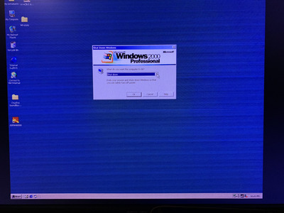

Hi
I'm experimenting with a system I've been given and I've come across a visual glitch which I can't explain. It happens reliably on the Wndows 2000 shutdown screen and I get static like horizontal lines across the whole shaded area, but the actual shutdown dialog is fine (see attached - not a great photo but you get the idea)
I've also seen the same glitch on the face plate of the default character in Quake3 when killed and it switches to the external view. No where else though, and I've run several other games and 3DMark 99/2000/2001 and haven't seen anything like it - everything looks fine. Looks like some kind of specific blending issue.

Have you tried a different monitor? If so, check the components around the d-sub/DVI connector.

rasz_pl wrote on 2024-03-24, 22:48:
Unstnced LCD, force your monitor to sync on this blue screen.

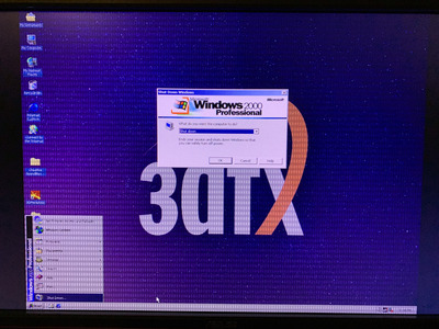

Thanks rasz_pl, that is the problem. I've learned something new about my monitor too!
Auto-focus was better but still off. Interestingly it requires different manual settings depending on what scaling the monitor does which I find slightly bizarre. In 1:1 scaling mode I get the proper stable dithered background with a high focus value (67), but with 4:3 or full modes I need different values for both, and get a weird pattern (attached) rather than the dithering. I shall have to play some more...

Looks like DAC issue.
Reply 7 of 9, by smola
It looks like usual effect of weak capacitors, just recap bigger ones to new poly/tantalum and smearing should gone.

Reply 8 of 9, by hornet1990
Unfortunately I don't have another monitor to test with, CRT or otherwise... something I will be looking at shortly.
However I have found that the orb/pill background only appears on the shutdown screen when the desktop resolution is anything other than 4:3, so it appears with 1280x1024, but not 800x600 or 1024x768 for example - they perfectly show the correct dithered pattern. So I'm thinking it's more likely an issue the monitor (Asus PA238Q) has with scaling non 4:3 resolutions.
Yes it looks like the phase is off on the auto sync. The monitor's VGA auto sync locks on best when the computer is displaying a tight checkered pattern. The windows shutdown screen is dithered so it reveals when the phase is off where you might not otherwise notice.
In this driver package there's an executable called testpat.exe. It displays the ideal pattern for the monitor's auto sync.
Run it, auto sync the monitor the press esc to exit out.
