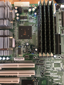

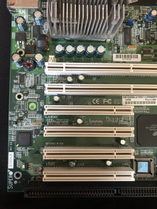

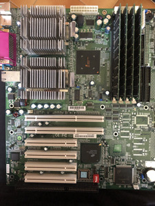

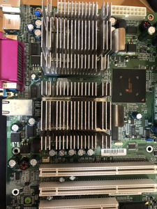

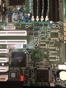

This is first time in my life I see something like that.
My 370DLE, purchased as NOS (with smell of new stuff included), that I used with a pci to pcie adapter with hd5570 gpu suddenly died.
No strange symptoms, no signs, nothing.
Today I push the button and no power at all.
I tried replacing the PSU, swap the CPUs, pull out of the case, tried both atx connections, used a psu with the 6pin old aux connector.
Nothing.
No power, no fans spinning, nothing… No smell of burnt thing around.
I really do not know what to say, not even know what to ask as it is really a weird occurrence…
Here some pictures, but I inspect it, I see nothing.

Reply 1 of 5, by dominusprog
Remove everything and check for shorts, then check the voltage of the mosfets.

Reply 4 of 5, by Mamba
kotel wrote on 2024-04-01, 13:36:
Maybe change the CMOS battery? My ASUS P4T-E didn't turn on without an working CMOS battery.
Not sure if it was that or my extensive cleaning with isopropyl alcohol, but the thing started again!
Thanks
Reply 5 of 5, by kotel
Mamba wrote on 2024-04-01, 19:12:
Thanks
Some older mainboards require an working CMOS battery. Glad you got it working again 😀
