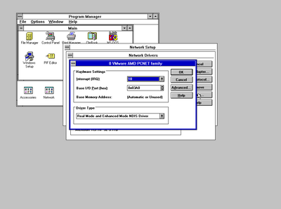

Reply 4 of 47, by flynnsbit
I mostly got through everything just fine.
Tested Dos 6.22 + Win3.11 for workgroups
I had a section of the install that unmounted the cd and just booted to dos with only smartdrv installed, remounted in VMware player and rebooted and it continued on its merry way. I think this was in between the dos and win install.
Because I chose to use SVGA and W311FW the login screen would cause the graphics corruption noted in the notes. I did at least figure out if you go change the IRQ for the AMD network card it will allow a graceful boot with SVGA + Network. That helped a lot and the only think that will bug out the screen is dos prompt.
Reply 5 of 47, by myne
What irq did you use?
It's set to.... 9? Or 11?in the network inf
Might need to test it with your setting
It's supposed to unmount the CD but it's supposed to continue... Hmm
I built:
Reply 6 of 47, by flynnsbit
myne wrote on 2024-04-15, 21:38:
What irq did you use? It's set to.... 9? Or 11?in the network inf Might need to test it with your setting […]
This is what I ended up on and everything seems to be stable, dns etc works and no weirdness with login prompt. Everything seems pretty good if you stay away from the dos prompt.
Reply 7 of 47, by myne
If you're comfortable editing infs, I'd be curious if it works better at to that to start with.
Just search for vmware in the network.inf
I won't be able to access a real computer for at least a few days
