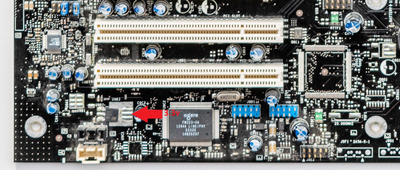

Reply 1 of 63, by Karbist
Does the north bridge heatsink gets quickly hot or it just stays warm? also leave the board running for 1 minute and put your finger on the south bridge chipset and see if one spot on the chip is getting hot.

Reply 4 of 63, by Karbist
Under the Intel logo is where the chip usually dies, you need to measure the resistance between the 3.3v standby rail to the ground,
I think this is where the 3.3v from PSU 5v standby gets created:
The attachment 3.3.jpg is no longer available
you need to verify it with your multimeter then disconnect the atx connector and measure the resistance.

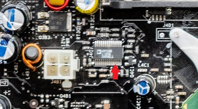

Reply 10 of 63, by Karbist
kotel wrote on 2024-03-03, 09:41:
On L4B1 inductor (next to the 4 pin CPU power) it measures 12.3v. On both L3B1 and L1B1 its 0v. I also forgot to mention that the speaker after mobo turn on clicks 1 time.
Do you have at least 1.2v on pin 11 of pwm IC (ADP3168)?
The attachment PWM.jpg is no longer available
Reply 11 of 63, by kotel
Karbist wrote on 2024-03-03, 10:15:
Theres 1.17v on pin 11.

Reply 12 of 63, by Karbist
So it's getting the enable signal but there's no cpu vcore. Are you using the right cpu for this board? some of these boards don't work with willamette P4, only Northwood and Prescott.
the next step is to check the mosfets, you need to measure the resistance between the gate leg of each mosfet to the ground,the mosfets on the high side should have the same resistance and the mosfets on the low side should have the same resistance.
then you need to measure every resistor below 10 ohms around the pwm ic and the mosfets to make sure they are not open.
