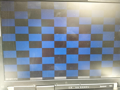

Finally found some time to work on this Lenovo Thinkpad R61I TYPE 7650-E8G. Installing Windows 7 with 4GB of RAM causes the 0xD1, 0xF7 BSOD'S. Linux Mint has no issues booting with 4gb RAM. The BSOD's go away when installing with 2GB, but after i install windows and change to 4GB of RAM the BSOD's reappear. Tried different sticks of 2x2GB RAM but same results. The BIOS is 2.23 from lenovo. Any ideas how to fix this weird behavior? Will the Middleton BIOS fix this issue?

I have several T61 and this issue never occured, they all run and got installed with 4GB (Win and Debian dual-boot).
Middleton BIOS fixes whitelists and enables SATAII as far as I remember.
Is your Windows 7 install media beyond all doubt / free of any corruption? Did you try a x64 setup?

Reply 3 of 15, by dr_st
I wonder if something faulty on the board can cause memory corruption issues beyond 2GB, in a way that just happens to upset Windows, but not Linux.
Did you try running Memtest with 2x2GB sticks installed?

Also tried installing Windows XP Home SP3 and these weird artifacts appeared. Same goes for pro SP2. Any ideas what might be the cause of this?

Reply 5 of 15, by DosFreak
Likely a driver or video hardware issue. Disable as many devices as you can in the bios to attempt to identify. Its also possible that there is a log or dump file you can grab.
Run memtest
If Linux works then verify by running software that requires the GPU and not just 2D, something equivalent to furmark.
Also in windows with 2gb run furmark and also disable as many devices as you can. Also try booting into safe mode with 4gb

Does your R61 have a dedicated graphic chip?
The T-models had heavy issues with ATI chips (defective video RAM), the Nvidias had the "Nvidia-bug".

Reply 9 of 15, by NostalgicAslinger
The problem is the chipset. The GL960 chipset (the GM965 does not have this problem and can handle 2x 2GB RAM, the T61 fore xample has this better chipset) of the R61 officially only supports max. 2GB RAM in dual channel (2x 1GB). Unofficially, however, 2GB+1GB in dual channel = 3GB also run without problems.
I also have an eMachines laptop from 2008 with this chipset and run it with 3GB under Linux Mint. With 4GB RAM (2x 2GB) I also have these problems with this checkerboard pattern under Windows XP.
I guarantee you 100% that this is the reason. The 960 is a neutered version of the full 965, and also doesn't officially support an FSB of 800MHz.
Kind of reminds me of the Intel 815, which was also limited to 512MB RAM...
So a 2GB and 1GB module is the max. way to go with the GL960, and also works in Dual-Channel Mode.
You can only search for the Thinkpad T61 model with the better GM965 chipset, if you want to use 4GB RAM.

Reply 11 of 15, by NostalgicAslinger
Only the T61 has the GM965 chipset, here are also more infos:
https://thinkwiki-de.translate.goog/R61?_x_tr … &_x_tr_pto=wapp
You can find the answer in this article:
Advantages: DVI via a docking station works; depending on the old board, the T61 board comes with extra mPCIe slots and has the better/faster chipset (R61:GL960 <-> T61:GM965) with the option of better processors.
kotel wrote on 2024-04-24, 15:19:
Problem is Lenovo says that my Thinkpad has the 965 chipset, but HWinfo says that its GM965/GML960. Lenovo also says that it supports 4GB. It also crashes with 2560MB of RAM.
Just remove the Northbridge cooler and you'll see if this is the 965 or 960 chipset. The tools always report GL960/GM965...

Whoops, my bad. It is Gl960. But the question still remains: why it BSOD's with bellow 3GB? The 2GB stick is the closest to mainboard and the 512MB stick, which is a know good one, is in the top slot. Ill try borrowing an 1GB stick form my laptops and see if that changes.

Reply 13 of 15, by NostalgicAslinger
kotel wrote on 2024-04-24, 15:56:
2x 1GB DDR2 667/800 is official support by the GL960 and 2GB+1GB unofficially, which most people like me drive. Also 4GB and 1GB = 5GB should work, here is a video for tuning up an Acer GL960 based Notebook:
https://www.youtube.com/watch?v=920NdUW7VEU
I have never tried out the 5GB mod, because a single 4GB SO-DIMM DDR2 module is too expensive for a 16 year old laptop.
The latest Linux Mint version runs very nice on my eMachines Notebook from 2008 with an T8100, 256GB Samsung Evo 840 SSD and 3GB memory.
I did not find any infos for 2560MB on the 960GL, but this could also be a problem for this chipset.
I think, that your Notebook runs fine with a single 2GB module?
The 2GB and 1GB combination should solve your problem, if not, then swap the modules in the slots and also clean the gold contacts of the memory modules with Isopropyl alcohol or spiritus.

1GB in the slot closest to mainboard and 2GB in the top slot seems to run stably.
