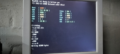

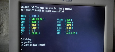

Reply 23 of 61, by highvoltage
I was so hopeful with this trip to the garage! I tried a typoless version (I think!?) of weeedeewee's suggestion, but the computer freezes after the M command.
I tried 640k's debug command, which seemed to work! But... produced another file full of FF (huh!?)
I'm also distracted by work atm so I'll do some more trial and error. At least we got to a point where the ROM was read, now just to get debug to write it properly (I'll also try one from freedos and DOS 6 fwiw)

Reply 24 of 61, by weedeewee
highvoltage wrote on 2024-04-26, 08:12:
yeah the freezing is likely due to the 1000:0
Change it to 3000:0 like 640KB said.
It is pretty weird though, displaying it works, yet writing to file doesn't. I admit I don't know too much about the workings of debug.
I guess doing a display dump of the bios at c800 would also be usable 😀
[code]D C800:0 2000[/code] nevermind that will require a little more command redirection to get it into a usable file for upload.
copy con dump.txt
D C800:0 2000
Q
^Z <- this means press Control & Z
debug <dump.txt >dump.bin
Do not ask Why !
