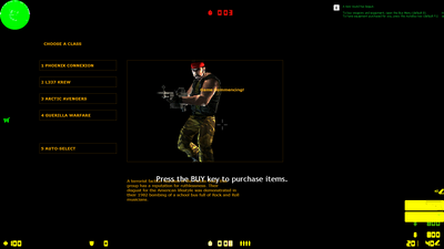

Although the Steam Condition Zero works fine, I am trying to play the 2004 original release of CZ with the VNG crack. However the game seems to crash when using the monitor resolution 1440x900 or 1920x1080 with a
Cache_TryAlloc: 2331984 is greater then free hunk.
Was there really a resolution limit in the game like this?

Problem is probably not with the crack, since I had to use it since upgrading to Win10 with no DVD drive. I did indeed check on WinXP now and it crashes at 1080p.
Not sure what's wrong considering all the 3 PCs have the same result
Edit: I am referring to SOFTWARE mode

Bad luck here
Edii: i consider everyone else to know better than me with the game commands. The game issues a "No masters loaded, using default master", usually before level loads. But on my machines it happens mid match, causing it to freeze. Do you know how to make this master load before I start a round

I am using 16-bit colors alreayd. Putting -heapsize 11111111111:

2,147,483,648 gives that it cant allocate 88 bytes.
2,147,483,649 gives that it can't allocated 2048942 bytes
2,147,483,647 gives that it can't allocate -0.00 MB
Edit: -heapsize 214748364 works, but now back to the original error in the first post
Run the game with -nomaster parameter. The game tries to fetch master server list from old Steam servers that are long dead hence the freeze as it tries to fruitlessly reach them. I never tried running old GoldSource builds at high resolutions so can't comment on that.

I can't believe it. That actually worked. Thank you so much!
