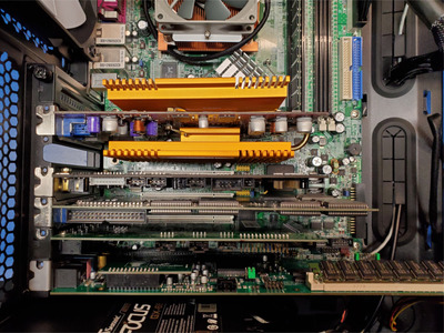

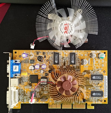

Have you used it with passive cooler?
Asking because I as well do not have original cooler only heatsink. I'm trying to find good balance.
It runs well with el cheapo 2 slot Chinese cooler, but it's overkill. Now I'm experimenting with original heatsink and brutalized Noctua cooler (pic below). I kind of like aesthetics and it's also quiet, but clearly less powerful. Double sided sticky tape mounting technique is also ... ... lets call it prototyping phase 😉
Seems to be working OK. I mean if you were able it run passively then I should be safe with low rpm Noctua fan.

Yes, it can run with this passive cooler, but it gets toasty.
While this passive heatsink it's not original from Asus, I got it from a third Ti4200 that was dead, so it's supposed to be enough for a ti4200.
You should be more than fine with your custom solution / noctua fan, even the original cooler heatsink combo at my MSI card is really light, not much aluminum on it.
Reply 27505 of 27660, by Kahenraz
I can confirm that the GF4 Ti 4200 can run with a passive heatsink, like the GF3 Ti 200. But it does get pretty hot, and probably isn't the best thing for it in the long run.
Even a small fan makes a big difference.
Reply 27506 of 27660, by Shponglefan
Can also confirm that a Ti 4200 can run with a passive heatsink. I'm using a Zalman fanless cooler, which is basically two giant heatsinks connected via a heatpipe.
Also have a couple 140mm intake fans that help push air towards it for good measure.

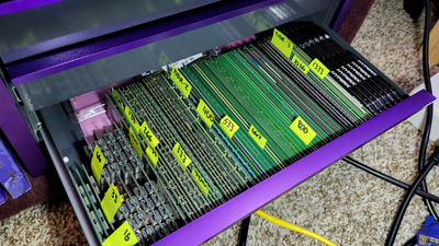

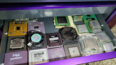

Ah yes. Today I finally got to organizing my processor and memory collections. I have inventory of all my CPUs now, in and out of systems. I got over 60 including the ones in systems. I didn't think I had so many until I sorted them all. Pretty cool to see them in one place, too.
    1.97 MiB
    426 views
    The Memory Drawer (DDR4 wasting a bunch of space)
    1.83 MiB
    426 views
    The CPU drawer. The not visable row is a bunch of PIIIs and a few 462 AthlonXPs

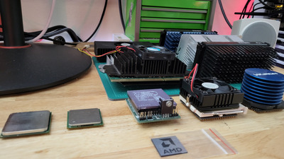

    1.39 MiB
    426 views
    The Slots and other unique characters.

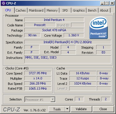

Today I did some mild overclocking on the 2.8ghz P4 Prescott, and using the box cooler and default voltage, it went up to 3.73ghz, P95 and 3dmark2000 stable. System power consumption at load went up by about 20W. Load temps are about 60C. That's basically a free 33% overclock, I honestly wasn't expecting it to go that high with stock cooling and voltage. But I'm not going to push it any higher, because I don't want to blow up the mobo VRM 😁

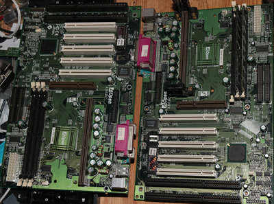

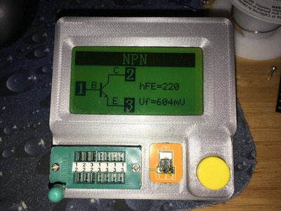

The last few days I've been stressed out / sad because my 'expendable' Aopen AX6BC motherboard became expended. In hindsight it was a comedy of errors, I saw Necroware / scorp's video on modding early S370 boards for coppermine ability and thought I'd try the same mod (relocating the RST pin) on a celeron slotket with this board. Then there were no POST codes and I thought I had damaged the chipset.
So I swapped to another W29C020 EEPROM fresh from ebay since that's the last thing I damaged and that continued the problem. I got the 2nd board out of storage and testing that - it won't come out of reset! Oh no! Both boards are dead by my hand????
Then I put the 2nd board's EEPROM in backwards and it melted the award holographic sticker ergh. Gotta work on how to determine pin1 position when refitting chips.
Now, I like the AX6BC because it's a pretty run of the mill coppermine capable 440bx board but nothing special, however... two of them, dead? Well, they came from a scrap lot and they have a history so nothing's that simple.
BTW I probably have somewhere in the region of maybe 10 or a little more slot1 boards but this is the only one where I have a pair of them and they're both capable of doing everything I want i.e. have AGP, ISA, coppermine support, so they've become important now. Oh and they stopped being cheap and plentiful a few years back.
On the 1st board I eventually decided to clean the socket with some card sprayed with IPA and swap back to the most recently working BIOS chip, and it worked again??? slot connectors are finnicky it looks like. The new EEPROMs which are chinese remarked type chips turn out not to work with this board which means these ebay special Winbond W29C020 chips fail at the very job they were intended for. Hope they work on something else.
Seems like the slotket dirtied the slot1 contacts to stop it working, then I swapped out the EEPROM for a bad one which stopped the board working with anything else.
This was all worked out pretty quickly as soon as I pulled out the oscilloscope, I knew the processor VCC was good but the scope let me see that clocks were all working fine and the computer was trying and failing to read data from the BIOS chip. Somehow I always feel that whenever I pull out the oscilloscope, I quickly reach an unsatisfying but meaningful conclusion / understanding of what's going wrong.
The 2nd board which was stuck in reset, well when I got it, Q7 had gone pop and I don't know whether I ever tested it. I took the neighbouring Q5 transistor off since they're marked the same and tested it as an NPN.
992.84 KiB
387 views
993.6 KiB
387 views
The same Q7 transistor gets pretty hot on the working board so idk if it's poor design or should be a PNP or what, but it'll get a heatsink. My understanding so far is that this circuit controls the ATX power on / power off maybe? The 2nd board could not be powered off after powering on via ATX power button.
Where I'd soldered the working Q5 transistor back in maybe I didn't do a good job? Reflowing the solder with fresh flux and suddenly the board is no longer stuck in reset and can POST with its original BIOS chip, so I'm back to two working AX6BC boards, hooray!!
Doing IRL stuff in the interim sure did replenish my energy for working on these though. Super glad they're both working again and I don't have to use one my fancy boards like my recently acquired Abit BH6 for general testing. In the end the faults were just 1. dirty slot1 contacts, 2. a bad chinese remarked EEPROM chip and 3. a soldering error on a transistor
