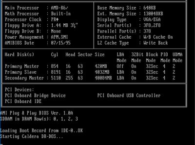

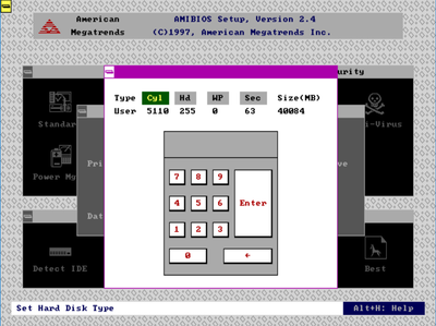

But be aware that a lot of these 1997/1998 AMI BIOSes don’t Auto detect larger than 8GB drives correctly and only give you CHS values for 8064MB. Therefore you have to enter the CHS values manually via the ‘User’ Harddisk Type selection in the BIOS. These so called pseudo CHS values for these larger drives can easily be calculated from the total number of sectors on the drive.
Set the Heads count to 255 and Sector/track to 63 and calculated the Cylinders count by dividing the total sectors number by 63 and then again by 255. Round the result down to a whole number and you have your Cylinders count.
Example: A 40GB drive has 82,092,176 sectors (of 512 bytes each). When you divide this value by 63 and the result again by 255, you get 5110.0016. So use CHS 5110/255/63 for this drive.
When you enter these values in your BIOS, you should see this:
And at the end of POST, you will see the same CHS and drive size in MB. I used the Secondary Master drive settings for this example.
This should work for drives up to 128GiB, but note that the drive size on the second POST screen is limited 65535MB. It will display this value for any drive larger than 64GiB, but the entered CHS values will be correct.
I hope this helps and I’m very curious if you can use a >8GB drive now with the 11/17/1997S BIOS.

Reply 83 of 96, by tauro
Chkcpu wrote on 2023-09-03, 17:29:
As you may have gathered, my main interest is the Award BIOS, although I did patch a few AMI socket 7 BIOSes as well.
But I never modified a BIOS to break the 8GB HDD barrier, Award, AMI, or otherwise.
As you probably know, this mod would involve adding the IBM/Microsoft Int 13h extensions to the Int 13h interface. As the BIOS Interrupt 13h handler is already a very complicated piece of code, I’m afraid such a mod is way beyond my expertise. 😉
I've read your guides, I'm very impressed. It's a bit too much for me at the moment to manually edit a BIOS file with a hex editor but I still can admire your work. I have done some small modifications with the BIOS editors such as unhide options. I know your main focus is Award, but since you posted about an M550 BIOS with support for 128GB disks, I had to ask, it seems like I misunderstood.
However, most BIOSes from 1998 or later will support the Int 13h extensions and I have seen this > 8GB support in several BIOSes from the second half of 1997 as well.
So I checked the latest M550 Release 11/17/1997S BIOS and was pleasantly surprised to find Int 13h extensions support in this BIOS, therefore it should support drives up to 128GiB and so will my patch J.2 version of this BIOS.
I could confirm that the IBM/Microsoft Int 13 extensions are installed in this BIOS, I used your tool for this.
So this is indeed great news!
But be aware that a lot of these 1997/1998 AMI BIOSes don’t Auto detect larger than 8GB drives correctly and only give you CHS v […]
102.27 KiB
38 views
AMI BIOS manual drive setup
71.13 KiB
38 views
AMI BIOS drive summary
That's a crucial bit info that I couldn't have guessed.
Once I "bricked" a 16GB CF card with a motherboard that only supported 8GB disks. I don't know how it happened. Maybe it's because I formatted the card inside Win98, which detected it's real size (16GB) but the BIOS didn't... and something went awry. It became so corrupted that there's no way to bring it back to life. It can only be formatted for 32MB now, but it's not really working. I'm not sure what really happened to it but it has left an impression on me.
So first I tried a 32GB card, with 61078752 sectors (as reported by fdisk on GNU/Linux), so 3801 CYL. Everything seemed right at first, albeit a little slow, but after two reboots or so, I started to get corrupted files, "Windows has detected a registry/configuration error.", and the filesystem then was irrecoverable. I used a 66MHz BUS and everything was within spec.
I installed Windows 98 SE three times on CF card and it was always the same corruption. So I gave up. I don't know if the card has a problem, but it has been working fine so, I presume there's some sort of incompatibility. Maybe 32 GB is too much for this BIOS?
Later I tried a 16GB card, with 31260096 sectors, so 1945 CYL.
This time things went flawlessly. It's working really well! 👏 😀
