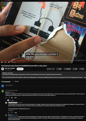

I was watching RMCs video on console ports of Mad Dog McCree and I found out that there was a PC version of the 3do gun that supported a light gun on vga monitors.
It connected via the parallel port and the gameport.
After some digging I found a video from a youtuber called bite size thoughts demonstrating it.
https://www.youtube.com/watch?v=dxOo_8q_rOs
and that got me thinking were there any other pc games in the 90s that had a native light gun option or is this the only instance of that.

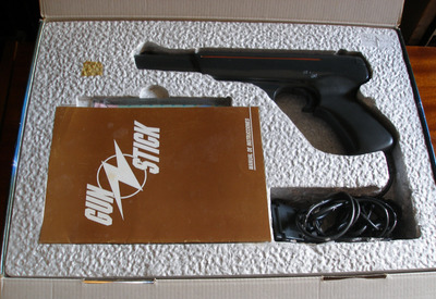

2) Spanish gun - called "GunStick" (1989). Connects to a Parallel port.
There were at least five games supported exclusively, by Opera and Dinamic, in 1989: "Solo", "Target Plus", "Mike Gunner", "Guillermo Tell" and "Trigger". And two more games, "Cosmic Sheriff" and "El Equipo A", had special versions for GunStick as well.
download/file.php?mode=view&id=210319

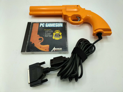

3) US gun - called "PC Gamegun" by American Laser Games (1993?). Connects to BOTH parallel and game ports.
All ALG DOS games support it! But not exclusively: "Mad Dog McCree", "Mad Dog II", "Crime Patrol", " Drug Wars", "Space Pirates", "Who shot Johny Rock", "The Last Bounty Hunter".
download/file.php?mode=view&id=210321

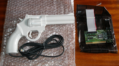

4) Taiwanese gun- called "PcGun", by EMAG and A4Tech (1996-1997). Connects to a special ISA interface card.
Only three games support it, all by EMAG: "A.D Cop", "A.D Cop - Overseas Mission" and "BonBon Paradise" / "BonBon Lite".
This one is for both DOS and Windows.
download/file.php?mode=view&id=210320

Uka wrote on 2025-01-19, 18:19:
As it says on the website Mobygames, Wacky Wheels game surprisingly partially support it too (did not checked it yet):
https://www.mobygames.com/game/433/wacky-wheels/specs/
https://csoon.com/issue8/wacky.htm
An important improvement between the PC version and the 3DO/Sega CD is the presence of a rubber protector against cable breakage, which was absent earlier (a known disease, treated by cutting the cable below the bend and re-soldering). The manufacturer, having realized the error, corrected this in the PC version.
The attachment Screenshot(5).png is no longer available
The attachment nVBcsN7YT_-JdqGki2OCaQ.jpg is no longer available
Doom is what you want (c) MAZter

I was also able to get "PC Gun" working, finally. The quality of aiming is not exactly high there, but at least in "BonBon Paradise" / "BonBon Lite," the gun is much more appropriate than the mouse.
