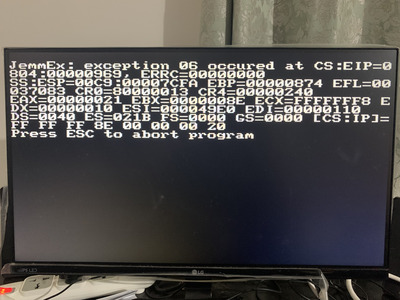

I know based on the below quote that Aladdin can work using SBEMU.
vico wrote on 2023-04-15, 17:02:
I found out why the music wasn't working, the Jemm386 I was using was a different version than JLoad.
I have updated my jeem386 and am now playing the games that use EMS properly.
Sorry for the false alarm and once again thanks for your great work.
When trying to run it myself (775i65G, 2 Gb RAM, YMF724), I'm running into a constant headache.
My config.sys:
DEVICEHIGH=C:\SBEMU\JEMMEX.EXE MAXEXT=32768
Autoexec.bat:
C:\SBEMU\JLOAD.EXE C:\SBEMU\QPIEMU.DLL
C:\SBEMU\HDPMI32i.EXE -r -x
I boot DOS and type:
C:\SBEMU\SBEMU.EXE /A220 /I5 /D1 /T4
and get:
The attachment IMG_1520.jpg is no longer available

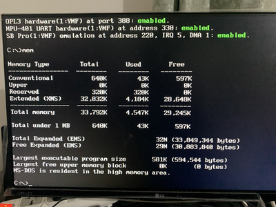

Typing "mem" gives me:
The attachment IMG_1521.jpg is no longer available

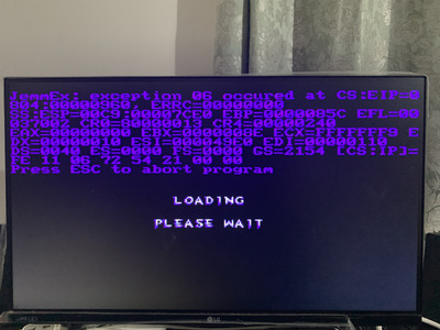

In setsnd, I enter SBPro, A220, I5, D1. And then on running Aladdin, it hangs on the waiting screen, giving the following error after a few seconds:
The attachment IMG_1518.jpg is no longer available
Following the exact same procedure with a different release (version?) of DOS aladdin gives a similar error:
The attachment IMG_1523.jpg is no longer available
In the exact same environment (i.e. after booting to DOS and running SBEMU), skyroads works perfectly with sound. But if I try to run Prince, again it hangs just at the loading screen (tried Prince 1.0 and 1.4 with the same result). Can anyone please help? What do I have to do to get Aladdin running normally with music and sound and all?

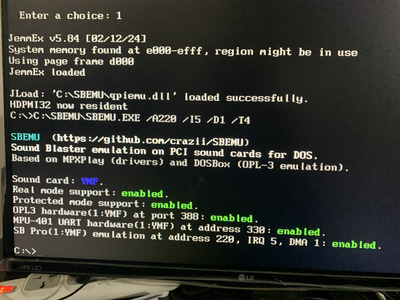

Reply 1455 of 1988, by Baron von Riedesel
xtreger wrote on 2024-06-10, 17:19:
My config.sys:
Aladdin is picky abou XMS, it should be a bit less than 32 MB - try MAXEXT=31744
However, the problem is most likely due to a page frame that uses non-free address space. You can try to force Jemm to use E000 or D800 as page frame ( i.e. option FRAME=E000 ). Jemm has found writeable memory there, and therefore excluded it as page frame candidate, but you'll loose nothing to try it nevertheless.
Finally, worth a try is to disable USB in setup...
Reply 1456 of 1988, by xtreger
Baron von Riedesel wrote on 2024-06-12, 11:49:
Aladdin is picky abou XMS, it should be a bit less than 32 MB - try MAXEXT=31744 […]
My config.sys:
Oh! I didn't realize you'd responded here. I raised this as an issue in your VSBHDA github repo. Let me try out the different MAXEXT value, as well as the FRAME=E000 option. I will let you know about the status after both these steps
Reply 1457 of 1988, by xtreger
My config.sys:
I got it to work! Even though SET BLASTER=A220 I5 D1 H5 T6 (i.e. seems like IRQ is 5), for Aladdin sound settings, the IRQ HAS to be 7.
