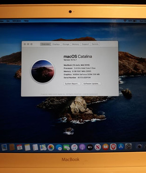

Also, I have a 2011 MacBook Pro where I used the DosDude patch to install Catalina. The process was → new hard drive → internet recovery install → allow it to finish all upgrades → then use the DosDude patch to install Catalina.
A lot of times when you first start out on a project you think, This is never going to be finished. But then it is, and you think, Wow, it wasn't even worth it. - Jack Handey

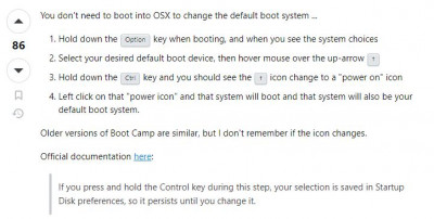

Reply 16 of 19, by Repo Man11
This thread motivated me to do something I've been meaning to do for some time - use Bootcamp to install Win10 on my MacBook. That was my intention when I upgraded the hard drive to a one TB SSD; I wanted to have each partition at 500 gigs, but I don't use this thing that much, so I got as far as installing Catalina and quit. But I could have used a laptop that haw Win10 on it the other day, and I gave my Windows laptop to my cousin when I got this one.
I began by watching a tutorial video, but I immediately ran into a problem with the optical drive not detecting the Win10 DVD. Turned out that the optical drive now wouldn't detect any CDs or DVDs. No problem, I see that Bootcamp can also use the Win10 files if you download them. But on my computer Bootcamp wasn't offering this option? Turns out that only works on computers that do not have optical drives! So I had to stop and take it apart and clean out the DVD drive. Luckily blowing out the dust took care of it, and it could then detect and read the Win10 disk and it began to proceed with the installation normally.
As I don't have much experience with Apple products (I've only ever used the ones I've gotten for free) I still find some really simple things to be a challenge. "Choose between OSX and Windows by holding down the Option key while powering on." "Okay, which key is the Option key!? Oh look at that, I guess it would be the key that says "Option!" Sorting out how the trackpad work in Windows is taking some getting used to, but so far things are looking pretty good. I would like to set it so that it defaults to booting to Catalina, I don't yet know if that's possible.
This did the trick:
