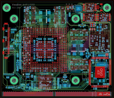

MXM3.0/3.1 TYPE A VSA-100 video card, for finally making a laptop with 3dfx graphics. I'll document it here as I think it will be quite interesting, it's not that straightforward shoving a VSA-100 into a laptop.

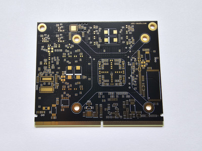

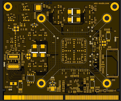

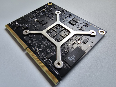

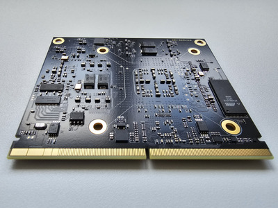

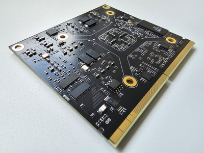

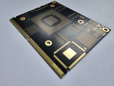

The PCBs arrived yesterday, and they look great:
The attachment S4.jpg is no longer available
The attachment S6.jpg is no longer available

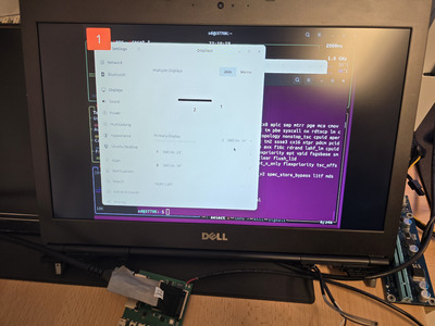

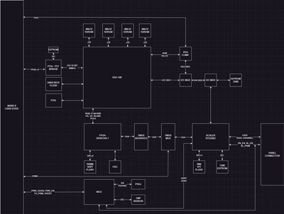

Laptops with MXM slots, want a video card with an MXM BIOS. Obviously, the usual V4 BIOS isn't MXM compatible. Also, the system BIOS would probably need to be edited to add the VSA ID to the whitelist. I don't want to mess with the system BIOS, or to attempt to make the VSA BIOS MXM compatible.
This means two things:
1. The laptop will not execute the BIOS on the video card. In the case of the VSA-100 it's not that bad. Many registers can be set with hardware straps, but not all. In this case, two important registers are not set to the value that is needed for such an application, vidInFormat[8] and vidInFormat[22] . Because of this, the digital RGB interface of the VSA will output scrambled Chrontel instead of unscrambled Brooktree format.
The attachment S7.jpg is no longer available
And this is how DVI looks with in such a setup (V5 5500 DVI):
The attachment S8.jpg is no longer available
The attachment S9.jpg is no longer available
On the V4 M4800 the usual TMDS encoder was replaced with an FPGA.

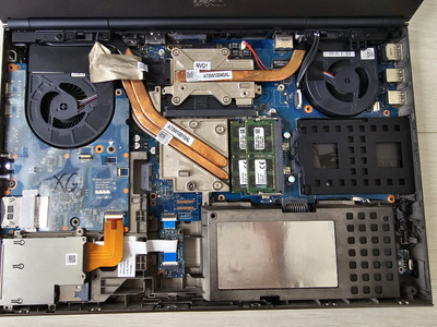

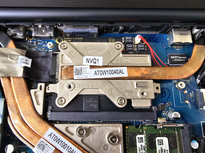

2. The laptop will behave as it doesn't have a video card plugged in. Because of this, if it's a laptop with an integrated GPU, it will not toggle the muxes to switch to the video signal coming from the MXM slot.
I intend to use the card in a Dell Precision M4800, which has the LVDS connector close to the MXM slot, so for keeping the solution as much as plug and play possible, I added an LVDS connector on the MXM card. Otherwise, some traces need to be cut on the motherboard. With this also goes backlight control via keyboard, but it may be possible to implement a workaround for this. More on that later.
Another important point is that a laptop screen has a fixed resolution. If the GPU is set to render at a resolution lower than the native resolution of the panel, the GPU will upscale that image so that the panel is always fed with it's native resolution. The VSA-100 will do no such scaling.
Also the panel wants to receive dual channel LVDS/OpenLDI/FPDLIK-I signal. Because of this, the card has a Realtek scaler, that takes the HDMI signal from the FPGA, upscales it if needed, and outputs LVDS to the panel. This is basically what's inside a PC monitor, added on the MXM card.

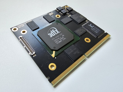

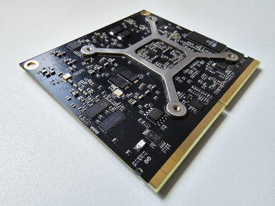

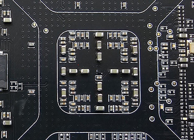

Reply 3 of 145, by sdz

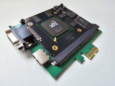

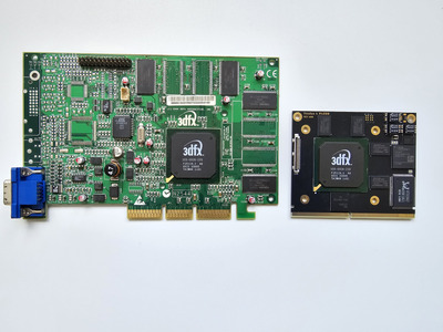

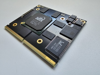

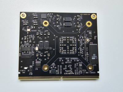

It is a bit crammed, as it's basically a 64MB V4, plus PCIe to PCI bridge, FPGA, the scaler that's usually inside a PC monitor, a microcontroler, power supplies, various flash ICs/EEPROMs etc. The size of the board is 7x8cm.
I just finished assembly (I'll wash the board better later).
Here it is next to a standard Voodoo 4:
The attachment S10.jpg is no longer available

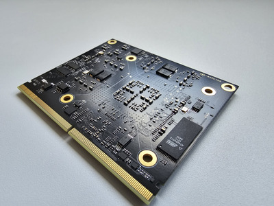

More photos:
The attachment S11.jpg is no longer available
The attachment S12.jpg is no longer available
The attachment S13.jpg is no longer available
The attachment S14.jpg is no longer available

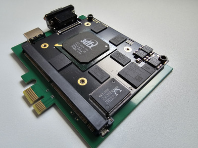

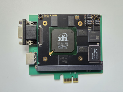

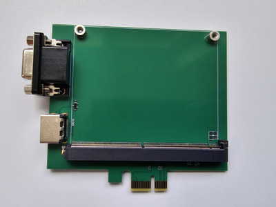

Also made an MXM carrier, so I can bring-up the board in a normal PC:
The attachment S19.jpg is no longer available
This looks absolutely ridiculous:
The attachment S20.jpg is no longer available
The attachment S21.jpg is no longer available
The attachment S22.jpg is no longer available

Reply 7 of 145, by sdz
Probably not, but I'll opensource the design.
Some good news, the card works 😀
Here's it running in a PC, with VGA output:
https://youtu.be/MKRf2rdHCFA?si=6mj1gPLrcQtiUlNY
Next step is getting the HDMI output from the FPGA working. There is a mux on the board, and the HDMI can be routed to the onboard scaler or the MXM connector. This will probably take a while.

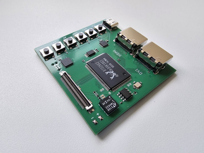

I made this small board with just the scaler, so I can work on this easier:

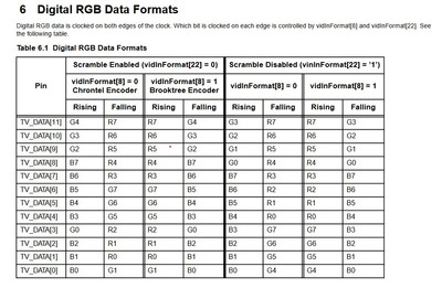

Next is to change the FPGA code a bit, for the messed up video format that the VSA-100 will output when plugged into a laptop.

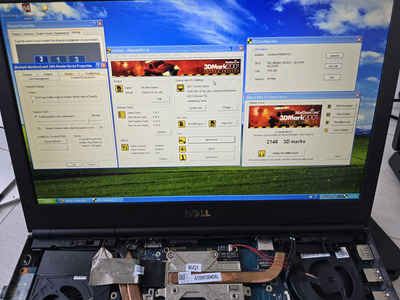

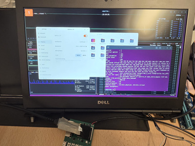

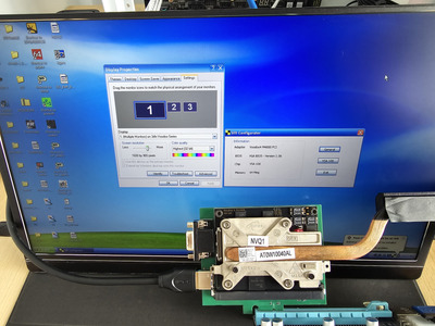

Reply 14 of 145, by sdz

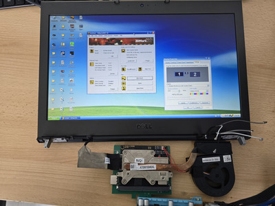

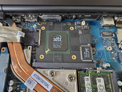

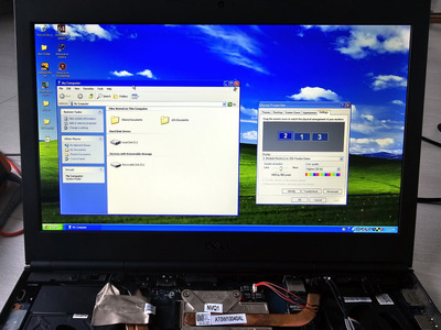

Here it is, world's first 3dfx powered laptop 😁
The attachment 20240604_150929.jpg is no longer available
The attachment 20240604_150325.jpg is no longer available
The attachment 20240604_150320.jpg is no longer available
The attachment 20240604_150201.jpg is no longer available
The attachment 20240604_150208.jpg is no longer available
https://youtu.be/f1h572CyArk?si=btRd7BH3IB-1CR8d
There are still a few things to do, fix brightness/contrast, figure out why the image is shifted right by about 5 pixels and fix it, read temperature sensors, control fan, send shutdown signal to host in case of overtemperature, and maybe figure out a way of controlling the panel's backlight from the OS. But the card works perfectly 😀

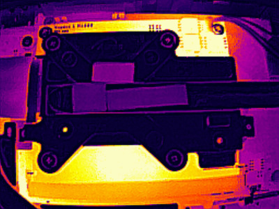

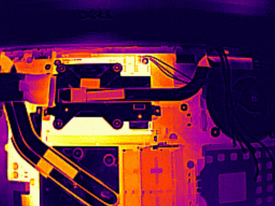

Also measured VRMs temperature, as these are not covered at all by the existing heatsink.
The attachment IMG_20220101_051228.jpg is no longer available
The attachment IMG_20220101_051231.jpg is no longer available
At 2.5V VCORE, 166MHz core/memory frequency, idle: 85.9C, load: 87.6C. This is well within spec, the VRM ICs are rated to operate at 125C. If it ever gets beyond that, the MCU will immediately shut down the power rails and issue an overtemperature event that will shutdown the laptop. This way nothing will ever get damaged.
VSA temperature is good, I can't yet say exactly what it is yet, but the cooling system works really well.

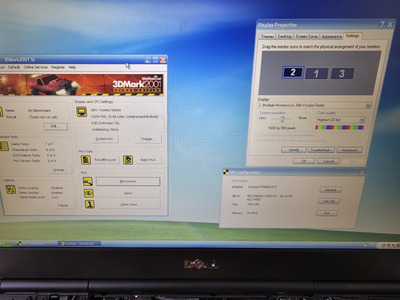

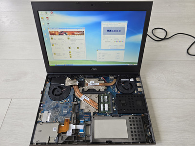

While I didn't manage to overlock the card with V.ctrl or VSA100 OC (in the laptop), it works with Voodoo 5 Overclocker 1.0. I managed to push the card from the stock 166MHz to 200MHz, at 2.9V VCORE. Not bad considering it's a 220 revision VSA-100 and 166MHz rated RAM.

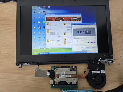

I have a couple of VSA-100 320 rev ICs, and I'll try to source 200MHz rated RAM. After that it should go higher.
With the card installed in the laptop, 64MB RAM, 200MHz core/mem clock, XP SP3, SFFT1.9, 3DMark2001SE default settings, 1024x768 32bpp, no tweaked LOD: 2148 3D Marks.
The attachment 20240606_144858.jpg is no longer available
