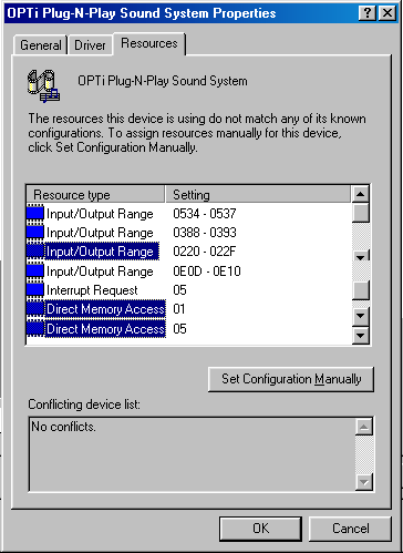

Reply 651 of 876, by Grzyb

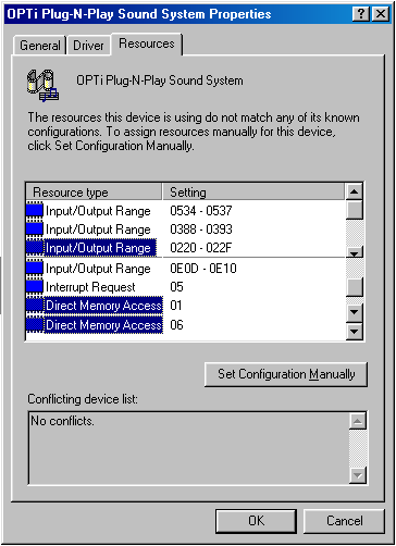

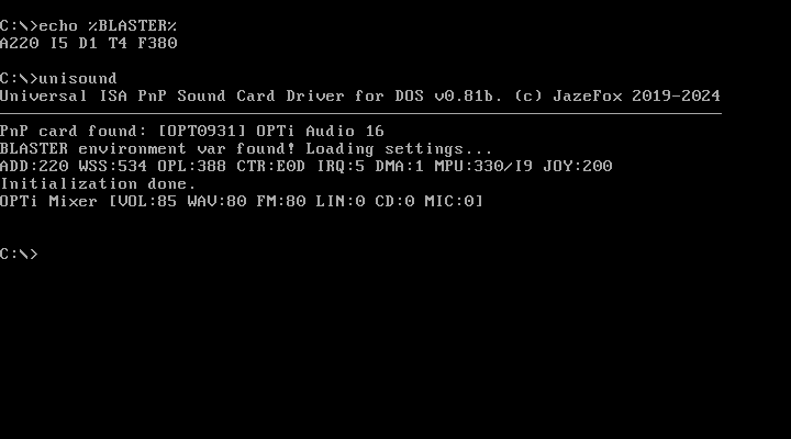

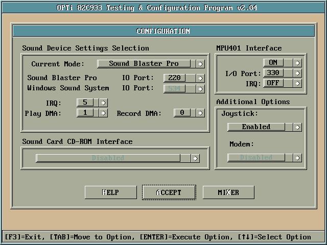

I've found a case where the original init utility works properly, but UNISOUND fails...
The sound card is some generic noname based on Opti 82C933.
The OS is Windows 98SE with BootGUI=0.
First, the original software...
The attachment 1.png is no longer available
The attachment 2.png is no longer available
The attachment 3.png is no longer available
Everything seems to work fine, now let's run Windows...
The attachment 4.png is no longer available
The attachment 5.png is no longer available
Still fine, can eg. run Winamp and play .MP3 and .MID files.
(continued in next post)
In 2003, I voted in favour of joining the European Union. However, due to later developments - especially the restrictions on cash usage - I have withdrawn my support. DOWN WITH THE EU!
Reply 652 of 876, by Grzyb

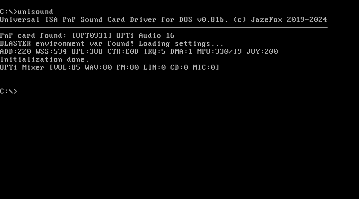

Now, let's replace SNDINIT with UNISOUND...
The attachment 6.png is no longer available
The attachment 7.png is no longer available
Again, everything's fine - notably I can hear both FM and PCM, eg. in SkyRoads.
Now, Windows...
The attachment 8.png is no longer available
.MP3 still plays fine, but... .MID playback fails!
Looks like it's playing, but can't hear anything...
Yes, I did check "Volume Control" - nothing wrong there.
Any ideas?
Note that the second DMA channel got changed from 0 to 6 - but this can't impact .MID playback.
More interesting is the fact that "Adlib" ports got changed as well - after SNDINIT it's 380-38B (strange, but works), after UNISOUND it's 388-393 (looks somewhat normal, but doesn't work)...

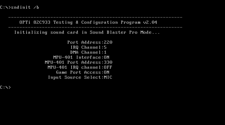

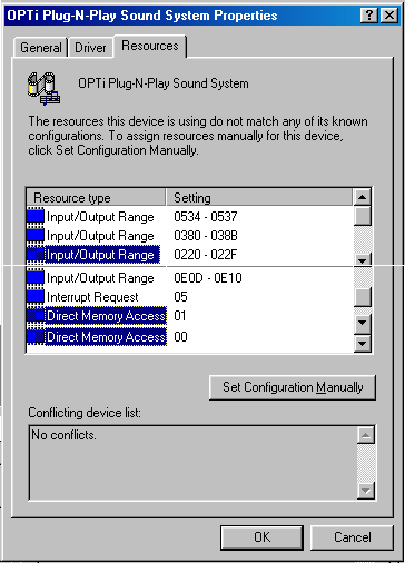

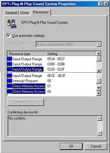

Reply 656 of 876, by Grzyb
Maxx1234 wrote on 2024-07-13, 18:40:
This may be a long shot, but did you try loading Windows without initializing the card in DOS?
Yes, works fine.
But I'm used to using Windows 9x as DOS - it's always "BootGUI=0", and I only run WIN when I really need it.
Initialization by SNDINIT doesn't interfere with Windows, and it would be nice if UNISOUND didn't interfere either.
UNISOUND does have certain advantage: SNDINIT enables SB mode only or WSS mode only, while UNISOUND enables both modes at the same time.
Sure, I can do some multi-config, or a bunch of .BAT files to toggle modes, but maybe there's a more elegant solution?
Meanwhile, I've replaced that Opti 933 with Opti 931 - the problem remains the same...

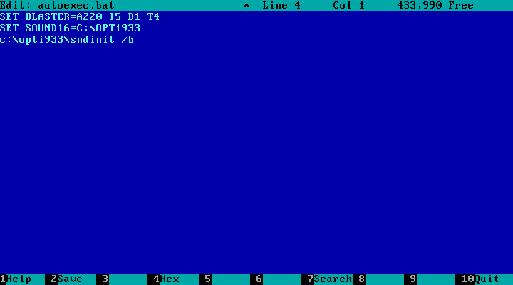

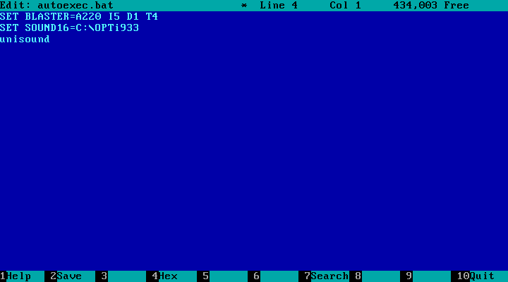

After fresh installation of Windows 98SE everything works fine:
After setting "BootGUI=0" and adding "sndinit /b" the config in Windows got changed, but everything still works:
After replacing "sndinit /b" with "unisound" the problem is back - PCM playback in Windows is OK, but can't hear FM playback in Windows:
Looks like the 380-38B range is OK, but UNISOUND makes the Windows driver to pick the 388-393 range...
Reply 657 of 876, by weedeewee
Grzyb wrote on 2024-07-14, 01:40:
Yes, works fine. But I'm used to using Windows 9x as DOS - it's always "BootGUI=0", and I only run WIN when I really need it. […]
Yes, works fine.
I was going to suggest changing the OPL address whilst looking at the UNISOUND.TXT file but...
  F: FM/OPL Base address. Default is 388. F0 to disable (not all cards allow
to disable or change this port!). Accepted values: 388, 398, 3A8, 0.
This option is useful, for example, to disable or remap CQM synth in
SB cards if you use other card with a genuine OPL chip tied to 388,
or useful for the future "AWE64 Legacy" project, with a genuine OPL.
Note that a few games (like Dynblaster) will try to use FM synth on
SB ports 2x0, and it will FM output sound (in SB with CQM for example)
anyway. Set FM volume to 0 to avoid it.
It looks like 380 won't be accepted. 😐
Do not ask Why !
Reply 658 of 876, by Grzyb
weedeewee wrote on 2024-07-14, 06:03:
Exactly...
The attachment f380.png is no longer available
