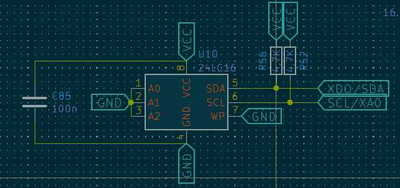

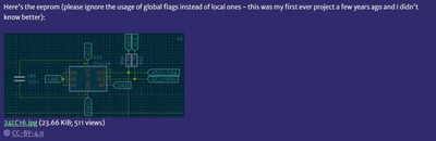

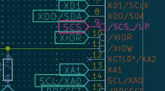

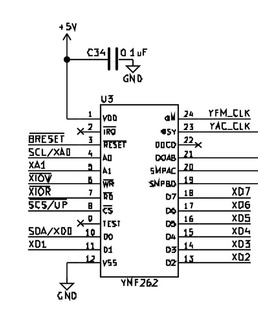

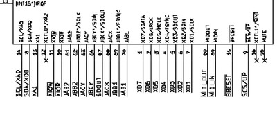

I've built mine with an eeprom.
SDA and SCL are connected to both the eeprom and YMF, with SCS being the Chip-Select for the YMF, afair.
Here's the eeprom (please ignore the usage of global flags instead of local ones - this was my first ever project a few years ago and I didn't know better):

Here's the relevant part of the CS4237B:
9.92 KiB
1052 views
And here's the relevant part of the YMF262:
24.43 KiB
1052 views
The programming of the eeprom is no issue with gerwin's driver / eeprom package from vogonsdrivers:
http://vogonsdrivers.com/getfile.php?fileid=9 … &menustate=41,0
Try and find the resource.exe and program it with e.g. a customized pnp37.ini
If necessary, I could try and find the one I programmed mine with (which is just only routing analog audio from the YAC and amp into the CS, though).
Hope this answers your questions?

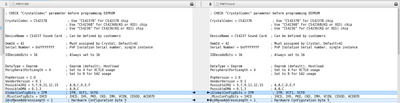

Reply 3 of 34, by MJay99
Of course, here is the visual diff (after removing other testing parts, I actually found I didn't really change much in the end):
97.73 KiB
985 views
This is using the PNP37.ini from the 'crystal_isa_audio_drivers.zip\EEPROM Resource\original' subdirectory of the above zip-file.
Again, there might be other (or better) ways to attach the YMF262, but this is the way I managed to make it work for me back then 😀

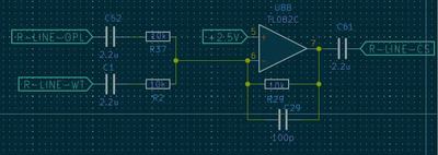

Reply 5 of 34, by snipe3687
Follow up question:
How can I route both the line-in port and the wavetable into the LLINE and RLINE port on the CS4237? I can't connect them together directly I'm assuming. do I need a DAC or something? sorry, I'm still new at this!
Reply 6 of 34, by MJay99
There might be better and maybe more HiFi ways, but this worked more than well enough for me:
27.52 KiB
897 views
If you run across another solution, please don't consider this a gold-standard idea and I'm always interested in other/ better ways.
And maybe there'll be others who want to chime in on this, too.

interesting so would you run the left line through the other side of the IC?
Reply 8 of 34, by MJay99
snipe3687 wrote on 2024-07-03, 21:01:
Exactly that, it's identical, just with labels for the left channel.
It's not used for amplification here (though it'd be possible by adapting the feedback resistor), it's just only mixing the signals.
And since the OPL and WT can't really be used at the same time, unless someone wants to create music soup, I didn't see much need for selective muting, etc.
If your WT would be noisy though, it will inject it into the output and can't then be selectively muted.
But that wasn't much of a concern to me either, since my WT-devices aren't an issue.
But if muting, volume adaption or the 'lowest-ever-noise-floor' is s something you're looking for, it might need more logic (and possibly a driver).
There's also no selective variable amplification for the inputs here - you could theoretically connect one of them to AUX and then be able to selectively influence the volume and muting with e.g. unisound, but as far as I remember, that's usually meant to be the regular Line-In (which is what I used it for).

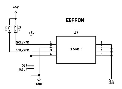

Reply 15 of 34, by MJay99
Which model is your EEPROM? The 24LC16 I was using does have a fundamentally different pinout (e.g. pin 5 being SDA, pin 6 being SCL):
20.63 KiB
540 views
Edit: The rest looks identical to mine.
