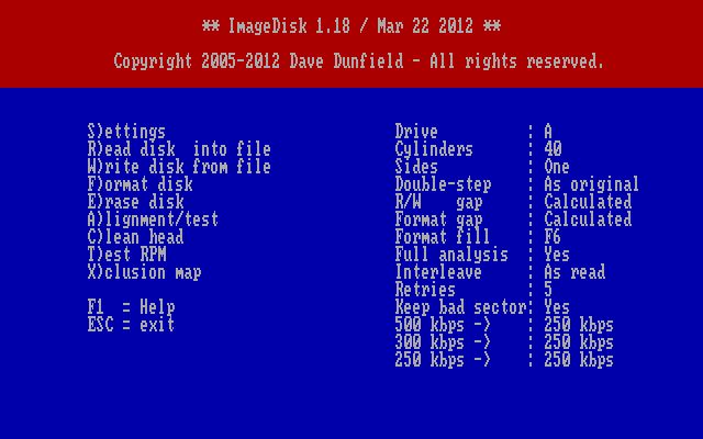

Reply 24 of 84, by Deunan
It's a program called ImageDisk, or IMD in short. While it can do some nice things it's a rather advanced program for creating sector-based floppy images. Frankly I think you'd find it rather frustrating to use, what with all the options that need to be set in it before it can be even used properly. Feel free to try but if you are going to hunt down more software then I think trying FDFORMAT first would be way easier.
Reply 25 of 84, by wbahnassi
Download ImageDisk from here:
http://dunfield.classiccmp.org/img/
Now the steps are from my muscle memory, so I might forget something:
  1. Run IMD.COM
  2. Dismiss the intro help text (press ESC)
  3. Press space to modify options
  4. Make sure Cylinders are 80 (1.2MB disks)
  5. Set Sides to Two
  6. Set Double-Step to False
  7. Press ESC to leave the options
  8. Navigate to Erase Disk and press Enter
  9. Insert your disk in drive A and start the process
Erasing is going to blindly write a full-track single-sector on each cylinder. This will erase metadata in-between the standard IBM format sectors and the disk will basically become in "Unformatted" state.

Hi I downloaded the program I’ve tried following your instructions but when I press space bar it just makes a noise
I’m not Shure how to get to format disc option I have tried a few options and I just get a error message ive sent a picture of the error message I get

Heh? Seems to me you didn't even get into ImageDisk at all. The program has a red/blue screen similar to this:
You get into this by running IMD.COM. Once there, the rest of my steps should apply.

Hi I actually got that screen when I started the program but when I followed your steps and tried pressing space bar it just makes a beeping noise and I can’t seem to change the settings and I’m not Shure what part of the program I use to format
