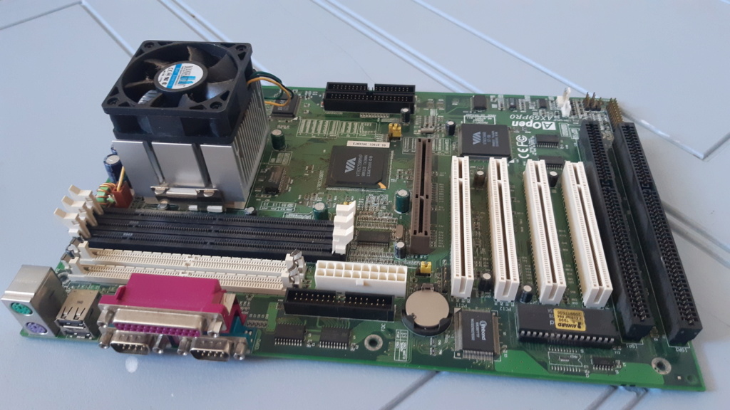

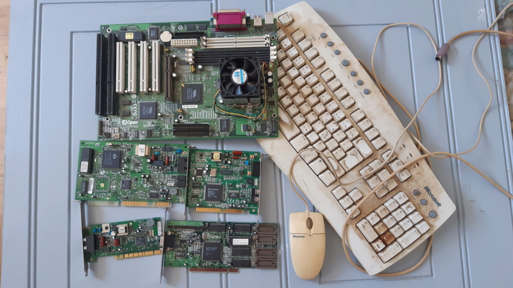

Found a few weeks ago.
It was waiting for me on the side walk, just a few dozens meters from home 😀
Sorry, not in a dumpster here ... Does it count ?
It's a AX59-PRO mainboard, with a K6-2 550 Mhz. No case, but mouse and keyboard.
So I went to a local computer store, hopping the guy would have some ram.
He had ram, but also a floppy drive, a All-in-Wonder 8500, a SCSI Adaptec 2940UW card, an audio card Aurel Vortex2, a 8139 network card, a Voodoo 2 12 Mo, and even blank cd 😀
I payed about 50$ for the whole ....
I changed 2 dead capacitors, but still have problem to get it running at 550 MHz, and Win98 crashes when I try to install the drivers for the Vortex 2 or a SB 128 1370 ...

Nice! I have one of those boards as well. I can't imagine finding that laying on the side of the road!
Regarding the board being unstable... you mentioned replacing two dead caps. Were they physically damaged, or were they leaky? If they were leaky or swollen and there are other caps on the board made by the same brand, I would replace those too, starting with ones that are the same or similar size to the ones that failed. Also, in my experience the very small aluminum electrolytic caps found on boards will rarely if ever burst or leak the way the larger ones do, but they could still be massively out of spec due to having the same defective internal chemistry that plagued other caps from that time period.
Also, I'd inspect it thoroughly for any damaged solder joints. If it was just tossed on the curb it could have some broken joints on the back, or even bent or damaged chip legs on the top side.
Reply 4664 of 4937, by nali
The caps I changed are the one near the CPU, on the 3.2 volts.
They were bulged, started to leak, and their ESR was about 5 Ohms 😀
They are the only of this kind, I know same caps have usually the same problems.
I had no blank cds, so installing a Linux was a pain. Now I have some, this may help me checking is there are some error messages in the logs.
The board was in a plastic beag just in front a a house, with a lot of books about aquariums.
So I suppose it was left here for someone to get it, not toosed.
It's quite stable at 350 MHz, so I don't think it's physical damages to the board.

I was using that keyboard during lockdown. I was a bit shocked how terrible it felt even compared to the PS2 keyboards that came with Compaq/HP business computers.
But I got used to it and by the end kind of liked it, even using some of the buttons up top.

...while the last picture clearly shows 4 defective ones?

Well 3 of the 4 are bulging but I would replace all 4 anyway (generally when you have bad capacitors next to the CPU which are all the same type and get heated up by the CPU cooler exhaust you should replace them all).
I've had boards where all the capacitors are bulging and leaking but the system still runs and boards where just 1 looks bad out of a few but the thing won't post.

The pictures are not in chronological order 😀
The stock capacitors are 4 x 1200 uF.
Since the CPU doesn't run at 550 MHz, I thought it may be the reason.
But I didn't have the right ones, so I temporary used 2 x 3300 uF. Correct models will be ordered.
I have other stuff to order at Digikey or other, to repair an old radio and a X-Box, I don't want to pay 12$ shipping for just 4 caps 😀
The caps are not new, but they are good.
