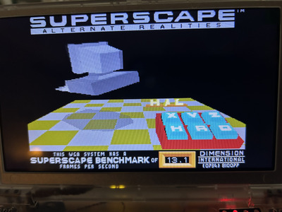

Could someone run 3dbench and tell me what the score is? I just want to compare the number to what I get with existing 386/486 computers I have.
Reply 347 of 560, by BinaryDemon
So interestingly I got 13.1 fps for both v1.0 (slow) and v1.0c (fast) from Phil’s Dosbench suite.
The attachment IMG_2401.jpeg is no longer available
That would be everything stock: hardware settings and software configuration.
